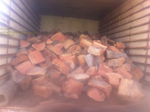

Anyway took a pic of the pantek this morning.
After 4 loads the rear right side gave way with a nice sound so it won't take long to empty then I'll set it up again on the main supports.
