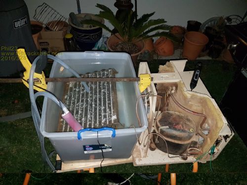

Recently pulled an old window rattler air conditioner out of a rental & figured I see how it worked as a heat pump.
The unit was rated at 1000 Watts input with a 1500 Watt cooling capacity.
So ripped the cover off, unscrewed the condenser & immersed it in a 50 litre tub of water to see what sort of heating efficiency I could get.
The Victim.
Condenser in a tub, 12v transfer pump to circulate the water.
Measured temperature rise & power consumed for calculations.

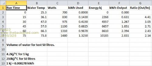

The Results:-
Not that bad, about 140% efficient, but a lot of effort required to make a decent heating vessel & plumb it all in.

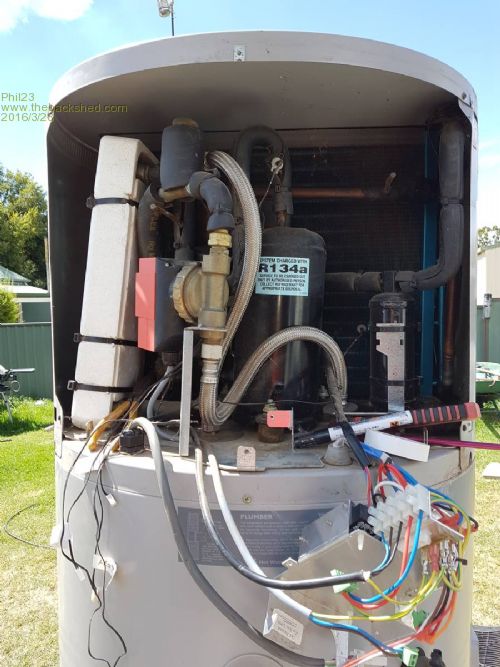

Spoke to a local plumber & air con guy, & he mentioned he had a few old heat pump hot water systems lying around I could have if interested.
So yesterdays exercise was to retrieve & look at one of these.
The unit he gave me was a Rheem with the heat pump rated at an input of 1300 Watts.
It had a dead circulation pump & a blown logic board. And lots of sensors....

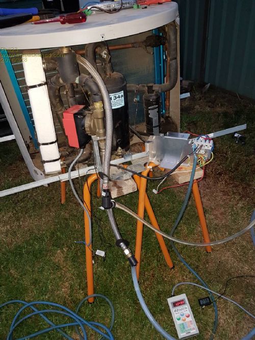

Removed the control board & found I could easily power the fan & compressor directly so nothing high tech required there.
Victim Number 2....
Connected it to the same circulation pump & ran the water from the tub through the unit & took some measurements again.

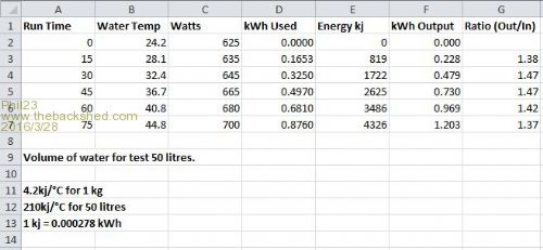

The Results of Round 2....
Really impressed with these figures. Over 400% efficiency.
Interesting to notice the way the power consumption increases with water temperature.
As mentioned the unit is rated at 1300 Watts (at 56°C), but at 36°C input it is only consuming 800 Watts as the compressor doesn't work as hard at lower temps.
A real benefit for my intended purpose as that's about as hot as the spa water would ever be.
