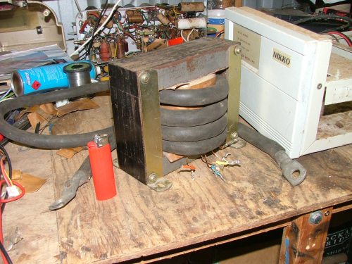

A quick search through the junk pile turned up an old Nikko UPS with a dirty great transformer inside. I cut off the secondary winding with a hacksaw, then wound some heavy welding wire around the primary. A quick test showed 4.2 volts AC output, perfect!

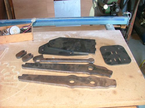

I drew up and lasercut parts for the spot welder "pincher" today. The parts were cut from 12mm and 5mm steel plate.

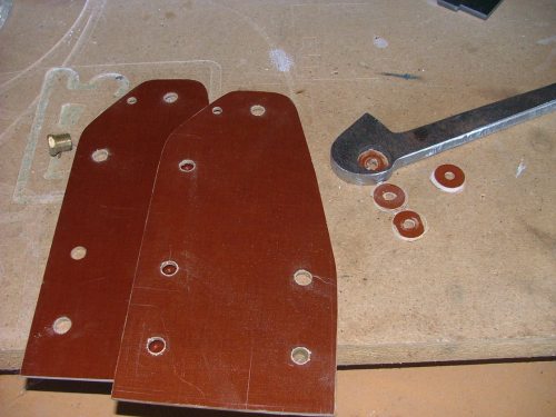

Once I got the parts home, I used the side plates as templates to cut some 3mm fibreboard. The laser can cut this stuff, but its messy and leaves a carbon rich burnt edge. As this fibreboard was to be used as a insulator, I didn't want any carbon edges, so it was easier to cut the fibreboard manually. I also used a hole saw to make up some washers.

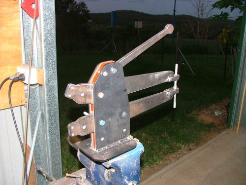

A bit of welding, and I put the bits together as a mock up to make sure it will work. Looks good.
The lever at the top is to clamp the tips together, I need to add a sping at the back to pull the tips apart.

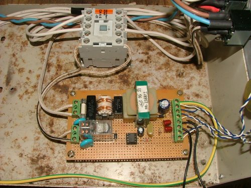

The circuit for mine will just consist of a one shot NE555 timer with a duration adjustment on the front case. This will switch a contactor in series with the transformer. The transformer itself has two primary windings ( actually they were the secondary windings when it was a UPS ), If I connect them in series I get just over 2.1 volts on the secondary, in parallel I get 4.2. I'll use a Hi Low switch so I can change between the two combinations. I figure with the Hi Low switch and timer I should be able to adjust the machine for any thickness up to say 1mm plate.

In welding transformers the output current is limited by the loose coupling between the pri and sec windings.
If you find you draw to much current try sec winding 1/2 on each outer leg core.

By my estimations you're expecting to get from 850 to 1500 amps per Zapp, is this about right for these things?
I'm thinking the primary of an UPS would be a fairly solid wire, this doesn't seem the kind of project a microwave transformer would be suitable for. Maybe a smaller version more like mine? Two in parallel might be better.

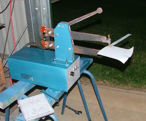

Finished the welder today. Made a foot switch from some 1mm zinc plate and a couple of DSE switches.
Below is the circuit, I need to draw it up. It uses a NE555 as the timer. I had to add a lot of spike protection, the back emf from the contactor and transformer was causing false triggering. I still need to tidy up the wires with cable ties.
The finished machine.

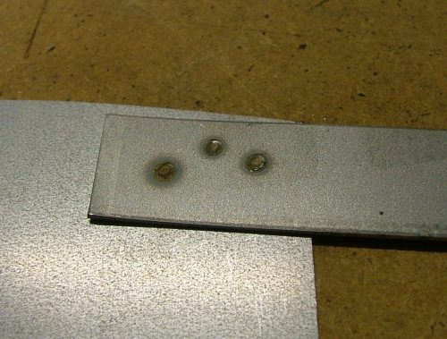

And some test welds, 1mm zinc plate.
I do need to replace the steel arms with aluminium, the steel gets very warm after a couple of welds, and this means I'm loosing a lot of the available energy in the arms.

Great job as usual. How strong is the "connection" between plates? Maybe the schematic will have his page on info/projects ?
May I suggest not to bother with alu arms as your results will even then still lack 'ummph'.
Try to get some suitable size flat braid copper and connect it directly to the back of the tip electrodes.
As was mentioned elsewhere in this thread, resistance in the wrong places kills a spot welder.
Ideally, you want 99.99% of the resistance at what's clamped between the electrodes.
Commercial small spot welders I used (years ago) had about 25mm dia copper rod for the pincer arms, one even had the arms water cooled.

Back to the welder, I was having problems with the 555 timer circuit, false triggering and unreliable duration, I think a lot of its from the back emf and slow response of the contactor, so I'm replacing the contactor with a couple of Triacs. Also kept blowing 10 amp fuses, I need to get some slow blow types.
