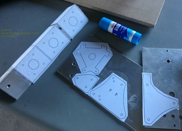

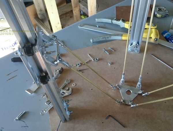

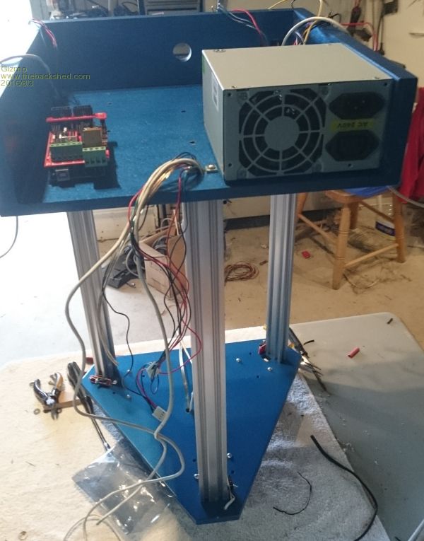

With all the bits I've started building the thing. Lots of fiddly design it as you built it, but its getting there.
I draw up the parts in cad then print at 1:1, and stick the templates to aluminium with a glue stick. I've used this technique a lot, works well, and once the part is cut and drilled, drop it in a bucket of water for 5 minutes and the glue dissolves.
Trial assemble of the rails, arms and effector.
Now the fun bit, wiring it all up.

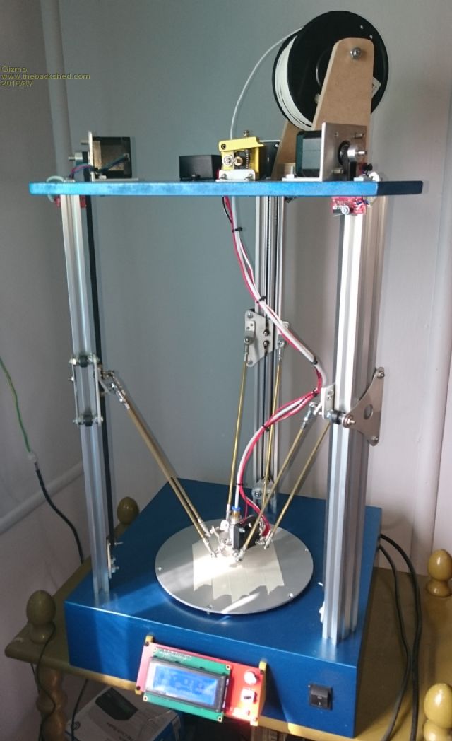

The printer is up and going.

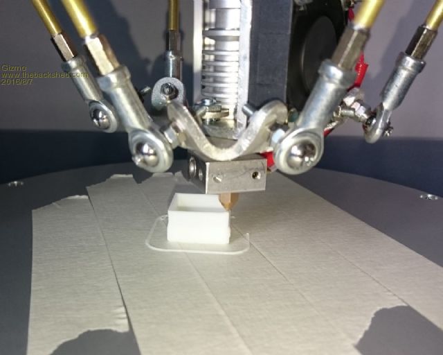

First print, a 20mm square test block. Played around with the extrude speed as it grew. Using PLA for now, I havn't rigged up the bed heater yet.

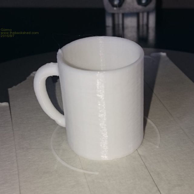

2nd print, a 1/4 size cup.
Calibration took about an hour to get it right. Next I'll order in some ABS and get the heated bed working. I also need to rig up a part cooling fan, the coffee cup has some issues where the new material was printing over area's that had not solidified yet.
Posted: 06:59pm 07 Aug 2016
That looks good.
PLA needs active cooling, ABS not so much, lower speed will give the ABS time to solidify a bit before the next layer.
Also making the print area enclosed so no drafts of air cools down one side of the print quicker then the other resulting in warp.
Also the slower it cools down for ABS the better the result.
