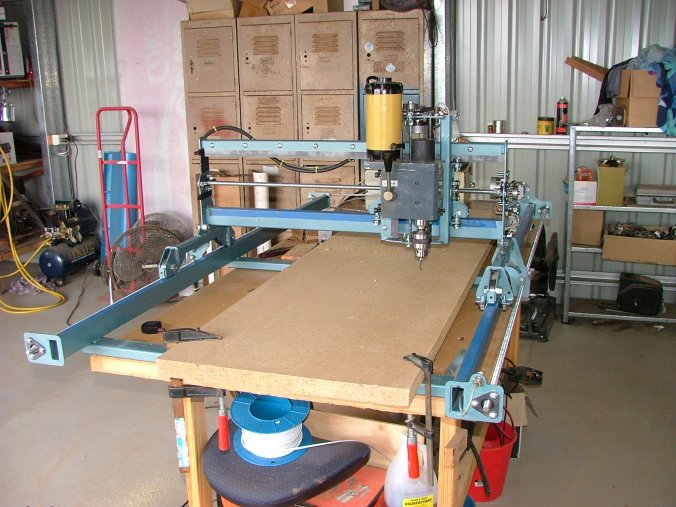

Well it was a hell of a project, took about 6 months of design, redesign, and scrounging for parts. Buts its finally working.

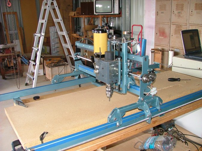

Has a work area of 1200mm * 600mm * 150mm. Below is a closer view of the gantry.

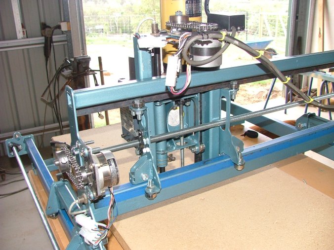

And around the back, you can see the lead screws and stepper drives. Using chain and threaded rod is not the best way of doing this, but they are cheap.

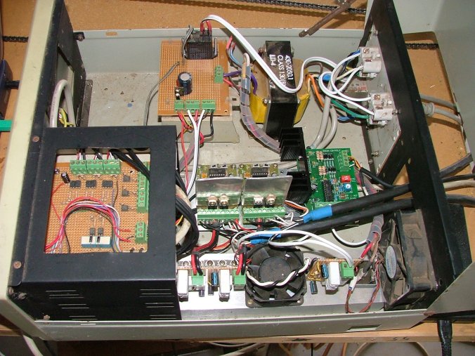

The electronics are housed in a old PC case. I want to upgrade the stepper driver boards, and will need more room so will move to a bigger case in the future. Its not pretty, but it works. The whole thing is driven from a PC using KCam software.

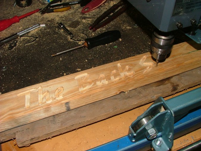

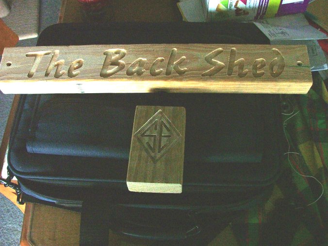

The first serious route job on a bit of scrap timber.
And the results.

Chris, I started with 3 of the Oatley stepper drives and built my own current regulators. I had problems with the X axis drive ( the one that has the most work to do ) so I ordered a new stepper motor and drive from Ocean Controls ( www.oceancontrols.com.au ). The stepper drive has its own chopper current regulator and can do half steps. The X axis now runs a lot better, the big stepper has lots of power. I will order another motor and drive from Ocean in the near future for the Y axis.
I use the half step function on the new drive, runs a lot smoother. If I could afford it I would get some microstep boards. Very smooth, and very expensive at about $300 each.

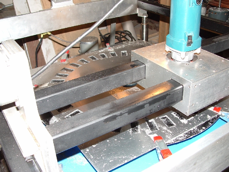

Gizmo, Joseph here. Here is a picture of my cnc machine I built last year. I am cutting 6063 aluminium. A template for a magnet rotor, first cuts on my rotary table W bed.
