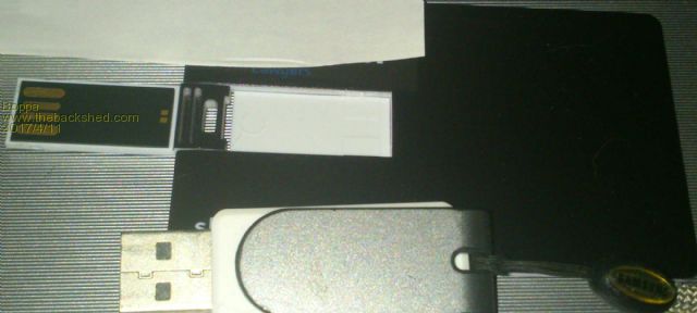

I was given a 8gb usb `creditcard' as a promotional gift the other day- for free
(edit sorry it was only 4gb, not 8)
(I covered over the company branding on it just in case)
Edited by Boppa 2017-04-12
