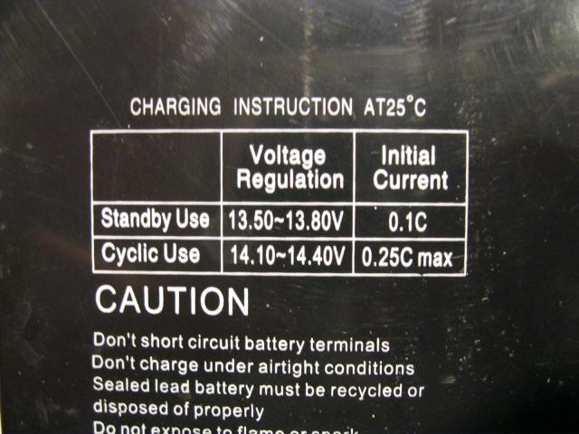

My daughter has a 36 Volt electric bike, but the batteries are dead (I measured 0.7 Volt across the terminals of each 12 Volt battery). So I assume that there is no hope of recovery. Each battery is 12 Volt, 12 AH.
Thus I'm looking for replacements. I have attached a photo of the info on one of the batteries. Could someone please tell me what 0.1c & 0.25c means?

Larny, AFAIK your 12Ah = C. So 0.1C = 1.2Amps, 0.25C = 3 Amps.
You cannot charge sealed batteries too fast hence they show the max charge current. Do use a proper regulated charger.

Thanks Klaus,
That's what I thought but could not confirm it with internet searches.
I understand that charging batteries in series is not a good idea as one battery can be overcharged (or possibly under charged) so I am intending to use 3 chargers - one for each 12V battery.
The reason I wanted to know the meaning of C is so I can design a current limiting circuit that will not allow the current to exceed the safe threshold.
So it appears to me that I should set the limit at a little less than 3 Amp. Is that correct?

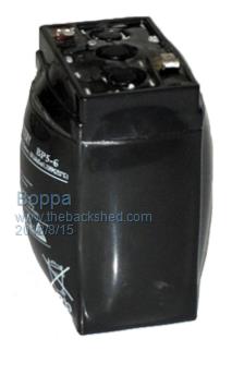

LA 'can' have balance issues, but its pretty rare (I have modified many truck battery installations with a piece of wood to 'shelter' the leading edge of the front battery, as the cooling effect of the air over the batterys at highway speed at night did cause issues long term with the coldest cell not getting charged properly) but I doubt that will be an issue in your case LOL

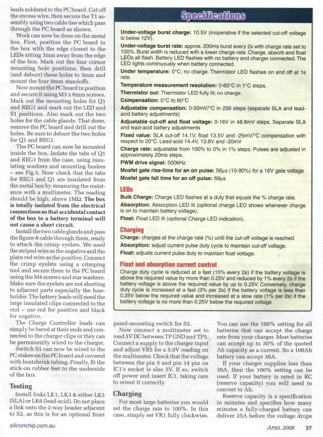

Some time ago, I bought the PCBs & parts to make 2 chargers. See the Silicon Chip April 2008 issue. I have posted the first page & the spec page
of the article below. I've been using one to charge my car battery & intend to modify the other one to charge my daughter's 36 V bike battery.
They appear to have done a thorough job. Let me know if you want to see more of the article.
