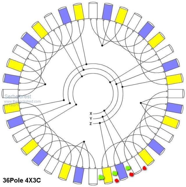

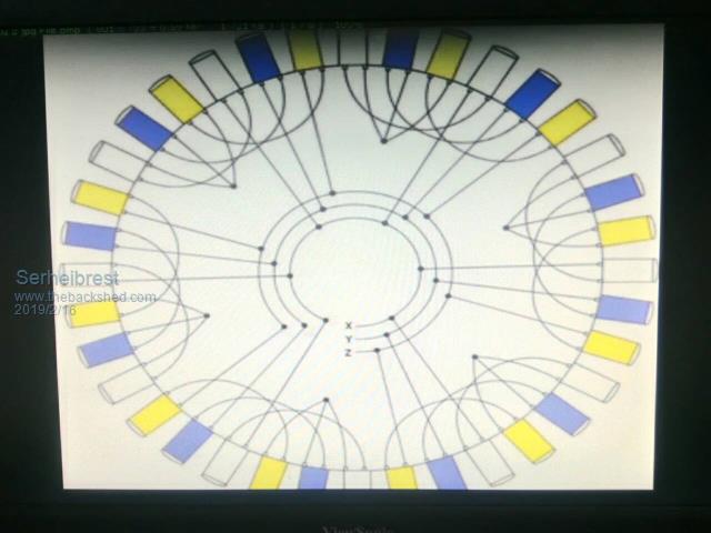

Winding from here Winding from here
my configuration 36Pole 6X2C
Please, show me in the picture where to put these three halls!

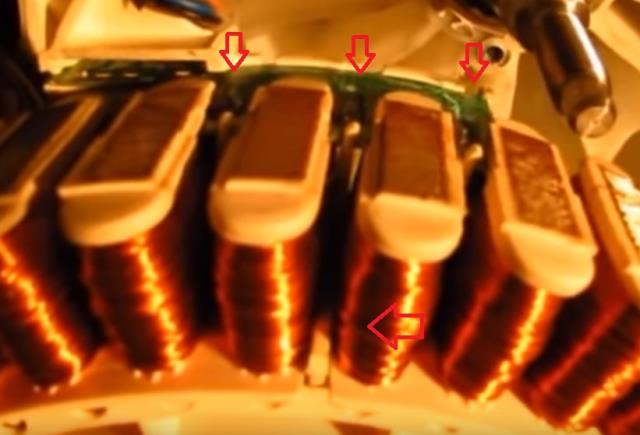

God, its been 6 years! I dont remember.
this is the original hall pcb placement the arrow at the bottom is showing the clip, you should be able to find the groove between the coils. How that relates to your modified stator ???.
I could try to find some of my old notes but I am fully booked this week with work and wont be home.

And how many sensors do you have? I have no original board. There should be three sensors on this rewinding wire. And my phases start in different places with the original.
I think there are two versions of the place, they are shown in the picture in red and green colors:
picture from
www.thebackshed.com/windmill/FPRewire.asp
I will test my theory on Monday or Tuesday, when my turner brings me a new shaft.Edited by Serheibrest 2019-02-18
