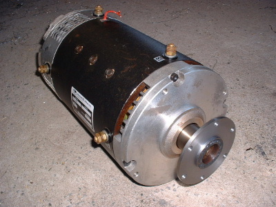

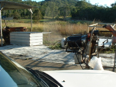

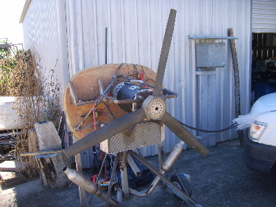

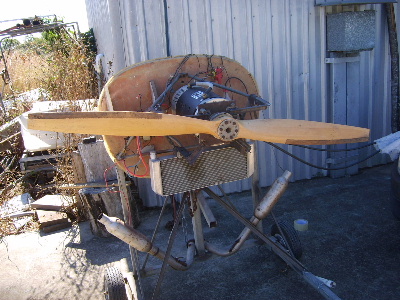

Swapped motors in the EV Hilux and with the motor out of the EV Hilux, we have done some initial testing for suitability &/or feasability for use in small aircraft.
While the test was exciting, it also was dissapointing. The motor could only reach 1500rpm, 2000 needed. The motor could only draw 220A. The rpm too low to allow more amp flow. Batteries were at 150v. This test used the standard propellar normally used on the aircraft. The pulling force only reached 92kg, just over half of the Subaru EA81 engine with a 2.5:1 reduction drive.
This motor would be good if we used a reduction drive, but we were hoping that we could do it direct drive. We changed the pitch of the propellar with some increase in pulling power. The next test will be with a shorter prop, smaller diameter.

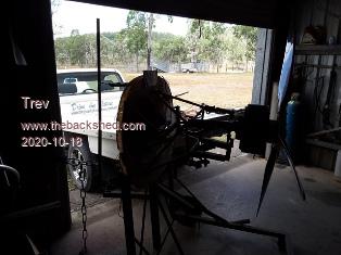

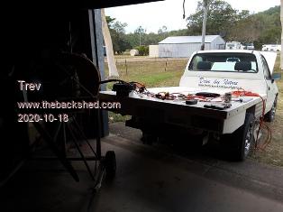

Posted: 11:27am 18 Oct 2020
A little history check.... I really believe the speed controller was the biggest issue with the tests done posted above. I have worked with other controllers since which are much better.

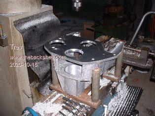

About the suggestion of Re-drive (previous post). As said above we were hoping for direct drive. As for sourcing.... no problem.... I make the Re-drive, cast and machine, see http://www.foxcon.com/Reduction-Drive.html
OK....now for an update

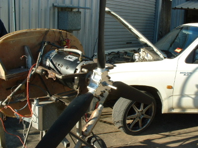

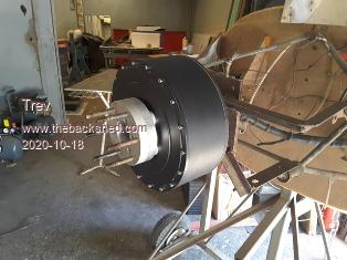

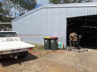

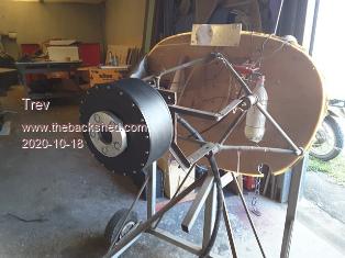

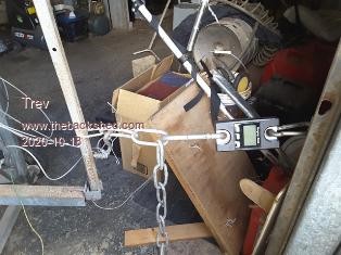

In Sept we tested a QS motor, 12kW rated vehicle hub motor. Rated to max 1480rpm and said to be higher than 350Nm of torque. While the rpm is lower than we wanted, thought it would be a good motor to run a test anyway.
Using the standard propeller on different pitch angles. Battery voltage of 155v.
28 degrees    1340rpm max    213A    pull force of 84-85kg
23 degrees    1378rpm max    180A    pull force of 84-87kg
18 degrees    1440rpm max    140A    pull force of 78kg

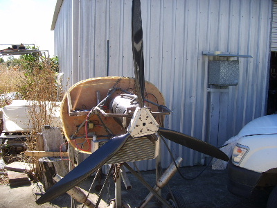

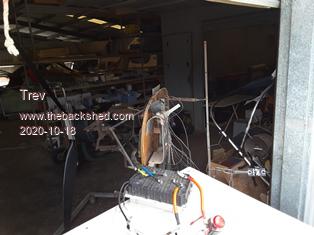

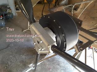

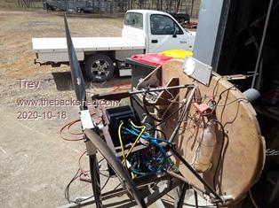

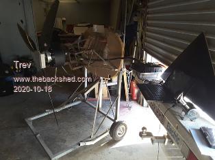

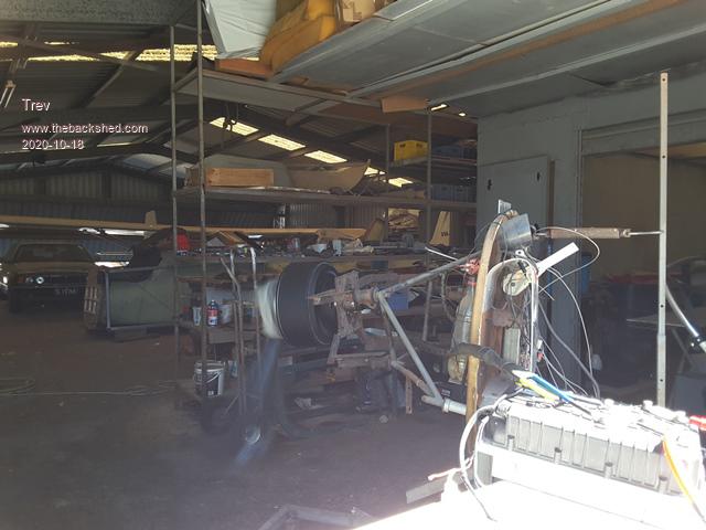

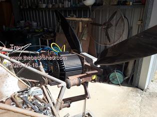

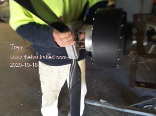

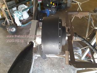

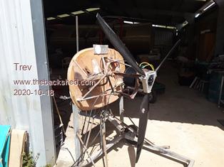

Today was testing a Golden Motor 10kW
With factory settings in the speed controller.....
Battery pack at rest 53v and under full load 46v.
Standard propeller.
Pitch angle 12 degrees    219A     1950pm    pull force of 96kg
Pitch angle 15 degrees    not as good as 12 degrees.
This so far has the highest pull force and the least draw of power. Seems too good to be true, but that's what we measured.
