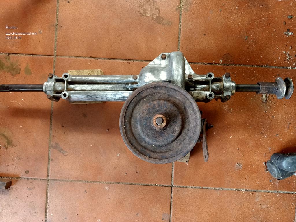

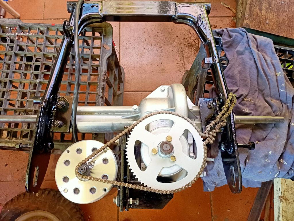

So decided to build one for around the yard out of junk (its what we do best) found an old gearbox from MTD ride on lawn mower took it apart and checked the gears and diff appeared to be ok.
Found the rear forks off an old motorbike, cut it in half and widened it to a suitable size and welded some box section in.
looking on line there are trans axles available for scooters and most of them are 250w or a little less, there are plenty of electric go kart parts available so went with a 24v 500w version with all accessories but with out the batteries.

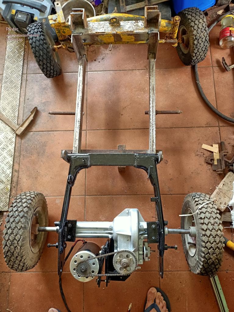

Some frame rails mounted onto the rear swing arm, the front end is off an old Rover Rancher lawn mower, We had this one since the early 1980's
Had to change the sprockets to make it travel a bit faster.
Cheers Aaron

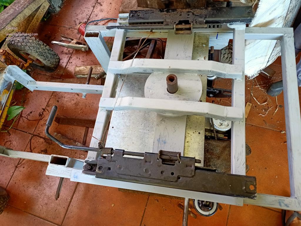

Swivel seat mount.

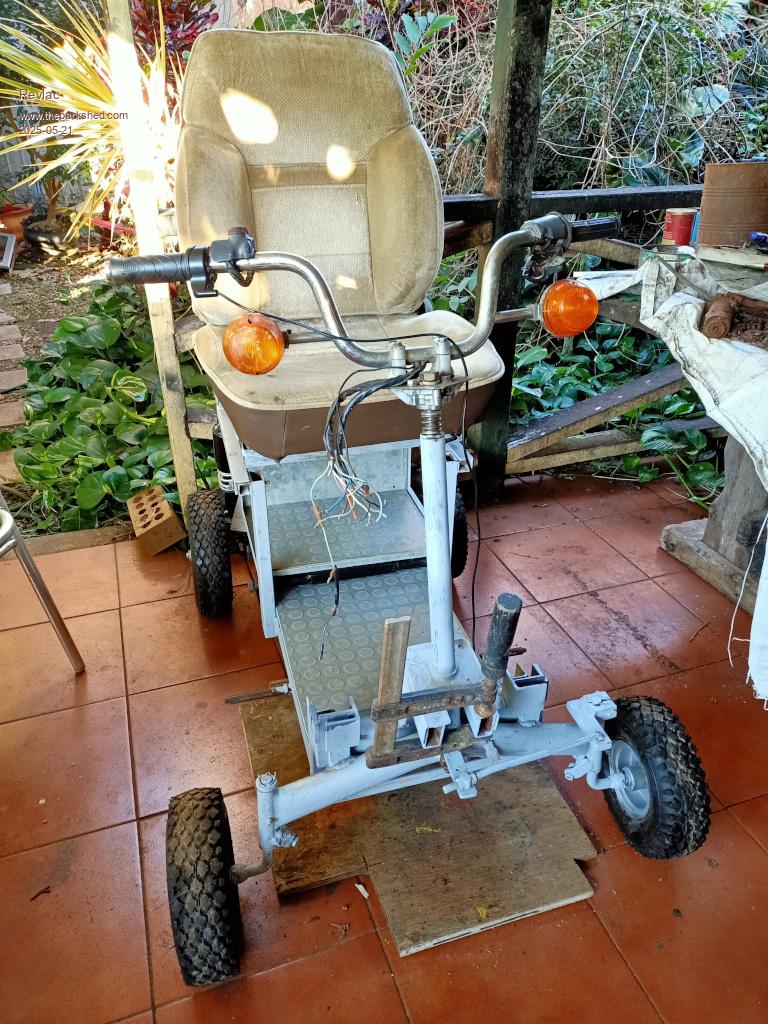

Thought its time for an update.

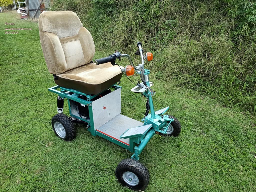

Bit more work done, steering is nice and responsive and the rear axle hubs are machined and fit the wheels nicely.
Parts include,
MTD gearbox
Yamaha rear forks
Ford hatchback front seat
Rover Rancher front
Honda handle bar
Nissan Datsun steering column....cut down to size.
And perhaps a few more parts yet, its very comfy to sit sit on, could  easy stay there for some time.
Still wiring to do and the bottom of the steering mount needs to be bolted on, just held by a clamp at the moment
Cheers Aaron

Looking pretty good Aaron. What size wheels did you end up using. You said in the beginning that the bought ones have small wheels. So wondering just what size you went with.
Are there any plans to make it 4 wheel drive in the future?

Thanks Pete,
No plans to make this 4wd, but Wouldn't rule out doing another one...perhaps much bigger, have plenty of 4wd stuff that could be repurposed, eg Subaru's, Nissan and other things transfer case etc.
Too many things to do at the moment.
Front tyre is 4.10/3.50  4 inch and  Rear tyre is 4.10/3.50  6 inch, so about 12inch overall, these were industrial tyre's we had bought many years ago.

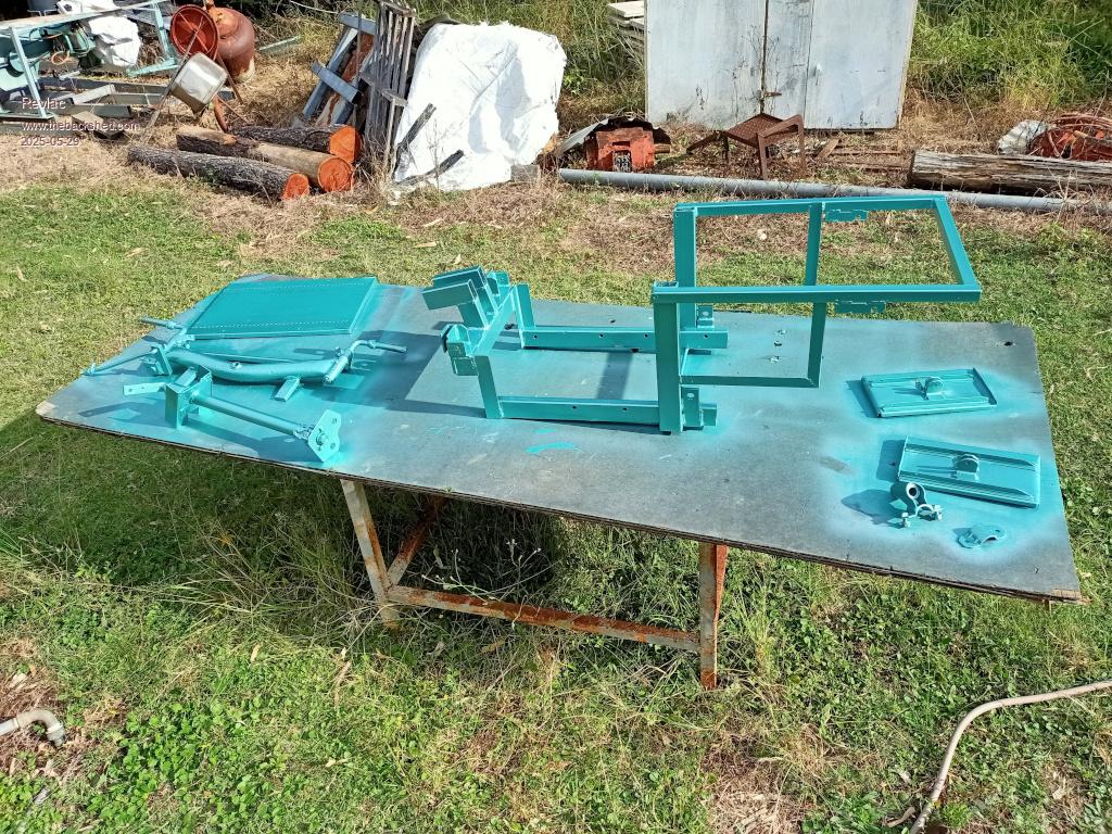

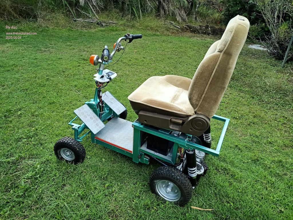

Time to take it apart for a coat of paint, Old Man wanted it a little different than others, And we had paint left over from other projects, I  was asked to find some of that old Hammertone, couldn't find that stuff for a while then Remembered there was a tin of Green Hammertone in front of the big old Diesel engine in the shed.
Thats the colour he wanted, so went with it.
Some of the parts painted, Will soon have it back together and then onto wiring etc.

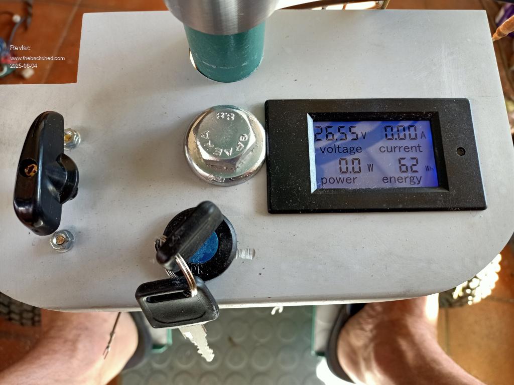

Did some wiring and fitted a few other bits, installed the 24v 50AH LiFePO4 battery and a main switch with shunt, put a small 20A inline fuse for the 500w motor controller, Time to give it a test run.
It run around the yard ok and then up a steep little hill behind the house and popped the little 20amp fuse, sort of expected that,  could see it getting 20amps and a little over on the power meter, still this was just a test so that fuse was sacrificial and replaced with a 30Amp fuse everything is working well.
Its not fast, just gets up to a brisk walking speed which is fine for around the yard, tried it going up the driveway (its reasonably steep at the front of the carport) and with some effort one could manage to give it all the throttle it had (leaned back) and managed to get the front wheels off the ground momentarily, no Chance of it going arse over...  on this driveway, if it was going to be used in steeper places then I would consider putting a safety bar or wheel at the back.
It will need a hand brake as is can free run down the driveway, no way to stop, there are a still a few things to do mostly cosmetic stuff, cover the battery compartment and lights etc, but at least its a runner.

I just put a handbrake on and a better brake pad, haven't tested it down hill yet, might find a small horn for it (to scare the animals out the way ) don't have any 24v ones here but will sort it out.
