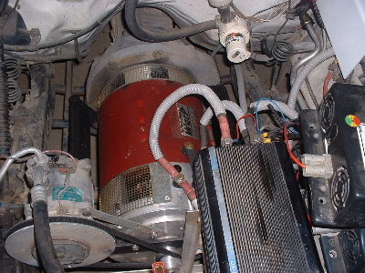

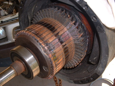

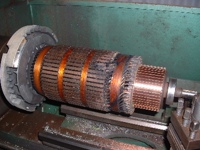

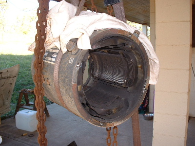

We have discovered how long a set of brushes lasts. This double shaft motor was fitted 347555. Speedo reading now is 384868. That is 37313km on the set of brushes. I would recommend changing them sooner than this. I run out of brushes, 3 car lengths from the traffic lights, in peak traffic. I just had to push it off the road. The Hilux is sign posted too. The word Electric on both sides and rear, as well as “Drive by Nature” and the website written on the vertical board at the front of the tray. Here is shot from our day at Eco Expo. You should be able to see the signage.
A little embarrassing, but at least we now know how far the brushes will go.

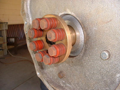

I pulled the motor out to check the coupling washers. All in good condition. Should get plenty of Km’s out of them.
I have read a bit about advancing the motor to get a bit more power out of it. Big mistake. So all those considering the same thing, I hope you read this post first. I advanced it about 6 degrees. There was no increase power, but reduced, and lasted only 9km. After dismantling, 2 comm bars were evidently effected and somewhat raised. Black burn marks further in on the armature.

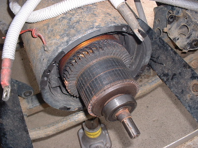

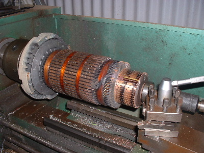

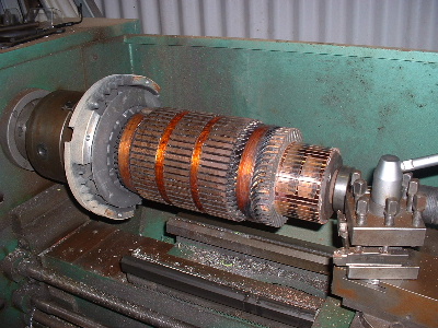

I removed the armature and spun it on the lathe. Cut a little on comm bars and can be seen in the pic. The shiny patch has been machined.
Then I machined the lot down till round again. There was about 0.5mm difference between the high and low patches. In this pic you can see 2 of the burn areas.
I put it all back together. The motor still runs, but has a lump in a 4 quadrant spacing around the full revolution. I have ordered a new armature. I have also taken this one to a motor rewiring business here in Mackay. It will be interesting to see if it can be rewired. They were going to have a look at it and get back to me.

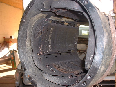

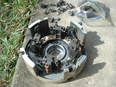

Here is a couple of pics from either end of the field windings.

Hi Trev
That looks expensive, are you sure that the 6 degree advance did all that damage. Was it poling as the look of the poles is like it was arcing bit, hard to tell from a photo.
The look of the com is like it had shorted turns in the windings. Did it damage the controller?

Looks like a starter motor I rewound out of a big grader a few years back.
It can't see any reason why the pro's couldn't rewind it easily. Those string ties part way up the armature look to mean that the slots aren't captive slots,.. hence the need for the tiedown. Should make it very very much easier to rewind.
It appears to be single turn wave winding, same as a starter motor. The only tricky bit I found was getting that "twist" at the output end right.
If you don't pretwist your wire to the right angles, you will never get the last 10 slots in. If you get it right, it is a doddle, and you wonder what all the fuss is about (took me 2 days to work out the right angle and find success... I'm a slow learner.), but I had the captive slots, (and I had to make the copper bars from 3 in hand 2mm wire) so I could not place them in the wide slots like that one appears. (mine all had to slide up the slotlength)
I'm not sure I would blame the advancing just yet, unless perhaps that motor was wound advanced, and your extra 6 degrees was then over the top advanced... but that's unlikely, as it would mean very poor reverse (unless your using the gearbox for this). I would expect that type of motor to be designed to perform well in either rotation. If it was better one way than the other, it may well have been biased already.... like a vacuumme cleaner motor. They are already near 2 full segments or so advanced. They will burn out in reverse if you rewire the fields to go backwards.... unless you shift the brushes about 4 segments back at the same time.
I agree with Bob, something did not do those field shoes any favours...... I'm more inclined to blame the worn brushes for messing things up.
If you lose one, you run on 2. You then draw the same (or usually much worse) current, and get less power out....
More in and less out = burn out... and thats not talking about the physical damage the copper wires in the dying brushes are doing dragging and spot welding onto the armature.... and possibly bits lodging themselves in between the armature and the field shoes.... maybe that explains the copper bits that appear to be stuck to the shoes in the pictures.
Not pretty at all..... now I will have to go out and check mine.
My few thousand Kms have all been done in the paddocks.... It won't be so embarrassing when the cows see me push it when the time comes.
......oztules

Poling, don't know. Possibly was arching a bit. But I don't recall any burn marks on the armature when I changed the brushes. The motor still ran smooth after changing the brushes. A little clicking in the brush area. I just thought it was the new brushes.
There were some of the old brushes that had stuck in the brush holder. In the pic above you can see at the top left the longest one. It had stuck and not worn down as the others. There was a bit a variation between the brush lengths. But of course it was when the brush springs reached their limit when all stopped. I had not noticed any reduction in power the few Km's before it stopped. Only metres before, it missed a beat.
Whether it had been damaged before or not the damage was evident after I had made the advance. After the damage, I went been back to the reading and found that the ADC is already advance 10 degrees. I had added another 6. The Netgain WarP motors are advanced 12 degrees. So with new brushes, is why I assumed it to be the advance.
There is a copper spray on the field wire. This has come from in the armature winding just in from the commutator.
It is possible that carbon or copper from the old brushes were lodged in between the comm bars or somewhere in the motor. I did run a scraper through the gaps between the comm bars though and sanded the comm bars with wet and dry sandpaper before refitting the end plate with the new brushes. Hence the first picture of the comm bars being quite black and the second picture is much cleaner. Only a burn mark half the width of the brushes. The brush holders were a bit floppy and the brushes had not seated in properly. I have now fixed the brush holders.
Now saying that, it could also be that I expected too much from it with the brushes not seated properly. I did do high speed for at least 5 of the 9 Km.
No damage to the speed controller.

[quote]I had not noticed any reduction in power the few Km's before it stopped. Only metres before, it missed a beat.[/quote]
This implies it was running on a single brush set. If all four were working, and one failed, you would still keep going at a reduced power. If you weren't pushing it hard, it may not be noticed much, just a bit sluggish.
When you lost the second brush, you lost the lot.... so thats why I still think brush... BUT
If you were already 10 degrees advanced, another 6 would be pushing it, and I would expect arcing under heavy load/high speed. If we had extra advance AND were missing a brush, were doomed under medium load and for full power... well.....

There is the possibility that the brush problems seen now, stemmed from the controller problems a while back. There would have been serious currents then, that could have damaged the brush holders.
It still seems like servicing is still needed at regular intervals. Maybe a permanent magnet motor and brushless controller is on the cards :)

Oztules, thinking about it, I did notice a little more power use in my normal day to day driving.
Gordon, that is a possibility too. When the speed controller burnt it just opened up battery pack straight to the motor.

Thinking about the situation with your motor it could have been some residual copper particles or even carbon build up that gave a carbon track effect inside the motor as the high voltage DC likes to run where it shouldn't and als0 if there was any sparking on the new brushes it can cause very high voltage spikes to set it off, once it tracked it would self destruct.

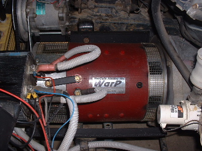

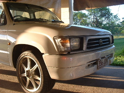

While the EV Hilux was off the road I decided to give it a face lift.
The damaged ADC motor gave me an excuse to go bigger. Though I will get a new armature for the ADC9. I have taken up dealership with WarP motors. ADC don't make an 11 inch. The new WarP motors arrived. About 2 weeks ago I fitted up a WarP 11. The adaptor plate fitted straight on, but I needed to modify the length of the coupling a little to work on the shaft. The shaft is the same diameter. The steel engine bracket was lengthened and strengthened.
I still have the Curtis controller. I wanted to compare between ADC9 and Warp11 with no other changes. There is a bit more torque in the WarP11. I can now take off in third gear and keep up with regular traffic, though still is not a super car. The other day I had a newer model 2.7 Hilux beside me, front row at the lights. I took off in third gear and he beat me, but only just, to 80km/hr (speed limit). Power consumption is similar to the ADC9. I will do a range test sometime to be more precise.

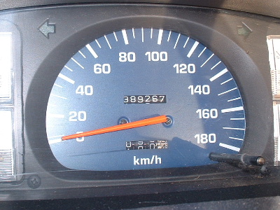

Speedo reading when I fitted the WarP11 is 384877 minus the 7km on the trip meter. That was the first test drive. So it can be taken from 384870.
It is now 385785 - 384870 = 915km in 2 weeks. I have to say I am happy with the WarP motor. I am sure that the other sizes in WarP and ImPulse would also deliver good performance.

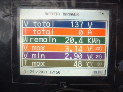

Range appeared to be better with the bigger motor. Yesterday I did the 100km/hr range test, driving the same road as all other tests. I still managed to get the 100km range. The speedo trip meter does not like to go passed the 100km mark, it jammed again about 4-5km from home. So range travelled was about 104km, using 20.4kw.
Last test I used 21.9kw to do 102km. (just checked old posts, made a mistake in the distance travelled, written 202km, should be 102km). So while it is not much, the WarP 11 is better for efficiency, than the ADC 9, in this vehicle at 100km/hr.
The batteries are wearing down. The 100km is all I could get driving mostly at the 100km/hr. There is still power in the batteries to drive slower, but I don't imagine it would be much. 20kw could be considered capacity now. These batteries were fitted with speedo reading 350153. So with current reading 389267 - 350153 = 39114 km travelled.
So for the way Bruce wanted it to be calculated....... (good on ya Bruce - great fella).
Battery cost is $1.80/ah x 45 cells x 200ah = $16,200 (price when fitted).
$16,200 / 39114km = $0.41 cents /km, but they are still not dead yet. The 20kw is still plenty for my daily driving, which uses around 16kw.
Of course the selling price for Thundersky at the moment is $1.52/ah. (Good time to buy).
If this were the price then, $1.52/ah x 45 cells x 200ah = $13680

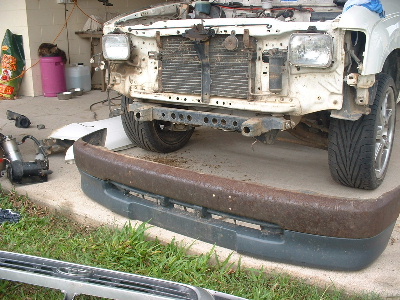

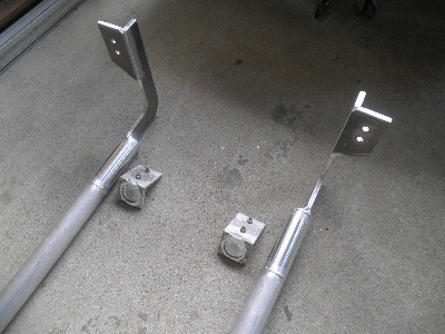

Planning to make a new wind gen tower. I need to carry long lengths of gal pipe.
But with the face lift on the EV Hilux front, I decided that the front carry bar should be mounted better, mounting it on the chassis instead of on the bumper. So welded up the holes in the bumper before painting.
I have just finished changing the bottom end of the front carry bar. Much better now, bolts to the chassis. In the first picture you can see what used to be on the bottom and the way it is made now.
