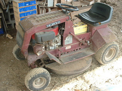

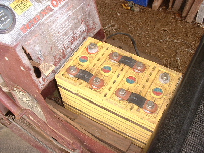

40ah Thundersky batteries may be too small for use as a starter battery. I use a Thundersky 90ah x 12v to start my mower and it would have no problem starting a car. You can check the manufacturers specs here, http://www.thunder-sky.com/products_en.asp

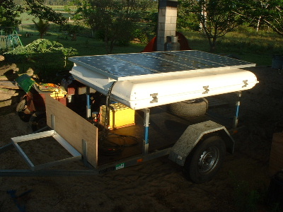

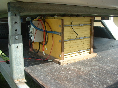

Charging from a solar panel is no problem. I use 4 x 80W panels on my camper. The battery is Thundersky 200ah x 12v. This setup runs my own made 12v 80 litre fridge for 4 days, maybe 5 days, without charging. I could use a 90ah but I put in the 200ah because I also run an inverter to a cook top for cooking.

That old mower start hard or something to need that big a battery?
