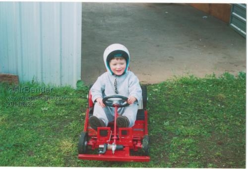

I thought I would post this build I done quite a few years ago before it disapears as it has already been rated for parts.I built this and had it running for my sons third birthday and it was used at least for a couple of hours everyday for years.
This is a picture of it in its prime not long after it was built.

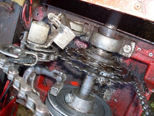

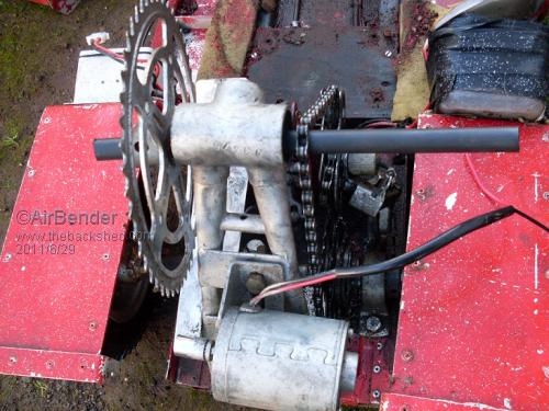

This is the gearing it ran which has been just sat back in place for the picture.
I used a 24 volt DC motor of an electric scooter with 2 12 volt motor bike batterys.
It ran two chains one from the motor to the large sprocket and then one from a small sprocket through a derailer to the three sprockets on the main shaft.
This set up worked very well I can only remember it losing a chain once in years of operation. Just a normal bike derailer was used.

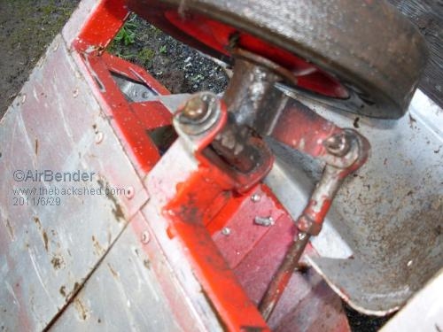

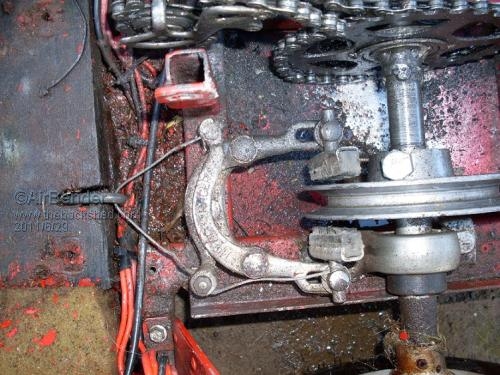

Here is the brake. A bike brake on an alloy pully which worked well.

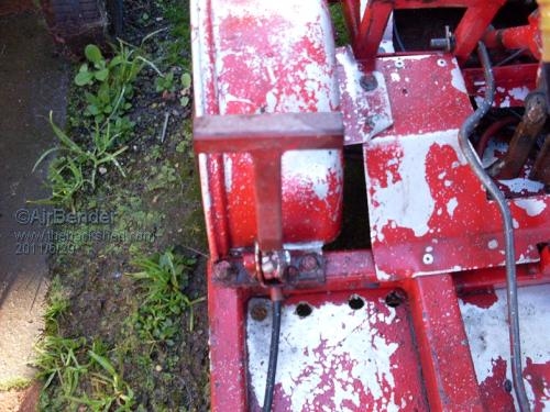

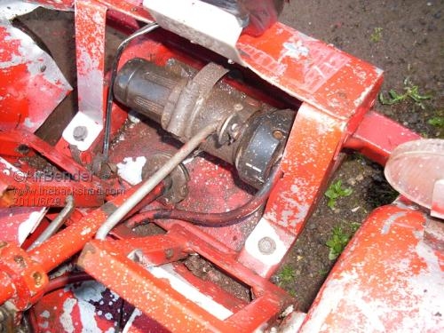

Here is a picture of the accelerater set up.
It is the original scooter hand throtle linked to a foot pedal.
