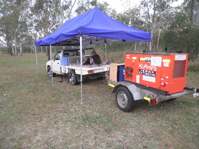

Then we found Volt Edge of Mackay. They had an 18kva diesel generator on a trailer. The trailer lights plug was even the right one to suit my EV Hilux. The price was very good in comparison to the other hire places. The question was though, can the EV Hilux cope with pulling it on a constant basis, at what speed and what would the power consumption be pulling the extra weight.
I went to see the generator. It seemed to be lighter than anticipated. The fellow allowed me to take it out for a test the weekend before I needed it. We needed it Wednesday after noon. This allowed me plenty of time then to mount the 3 phase Thundersky charger and run the charge cable professionally with trailer hooked up on the tow bar. Made the job so much easier. Thanks heaps to Volt Edge. I really appreciate your help.

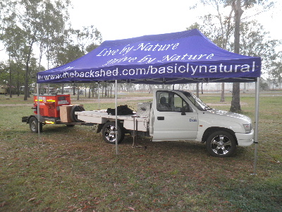

We (Marcy, Dale and I) left Wednesday after work (teaching). My teaching colleagues thought it rather funny to see us drive off with the generator running. The generator run the 3 phase Thundersky charger, 60 amps and both Zivan NG3’s (the normal EV chargers, 17 amps each). That give a total of 94 amps, enough to keep us going at around 80km/hr. Here is camping on Wednesday night. We slept on the back of the ute with the marquee over us, no side walls.

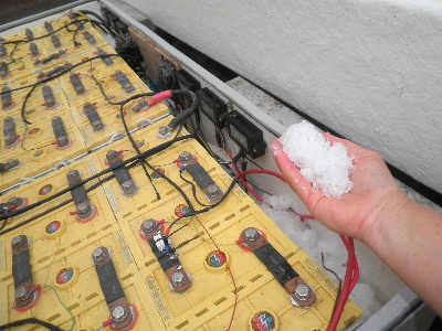

The batteries got quite hot, 70 degrees Celsius. We were about 20km from Childers. We stopped and pulled the tray off to allow it to cool some. Seemed to take forever, only about half an hour, there was a dark storm cloud coming over head, we decided to cover the batteries and move off. Just as we were loading the stuff on the tray, and strapping down, the rain started. Got in to Childers, removed the tray, put in water around the batteries, twice, draining out hot water. This was much quicker, but wanting to keep going, put in 4 kg of ice, put the tray back on and got going again.

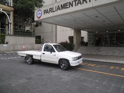

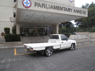

Friday was the AEVA Conference. We got going early to ensure car parking at the Parliamentary Annexe in the centre of Brisbane. We left the generator at Redcliffe, driving on battery only.
A great day with so much to learn. Almost every vehicle manufacturer are working on EV’s and most will have something on the market in a few years. You may already know about the Toyota Prius Hybrid. There is a company making battery packs to convert them to plug in. Mitsubishi iMIEV is currently available, it is pure EV. Infrastructure is being planned. Some places already have charging stations.
It was great to hear the update on Telsa. The roadster is currently available in Australia too, with the Model S & X in planning/development. It was great to hear about the development of the lithium battery industry, the types of chemistries and their properties. Listened to the update on Tritium too. Tritium are the super 3 phase speed controllers (& made in Australia too).
It was an excellent day.
Here is some photos in front of the Parliamentary Annexe.

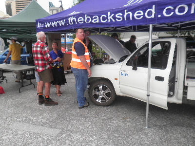

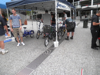

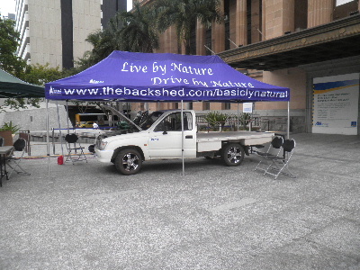

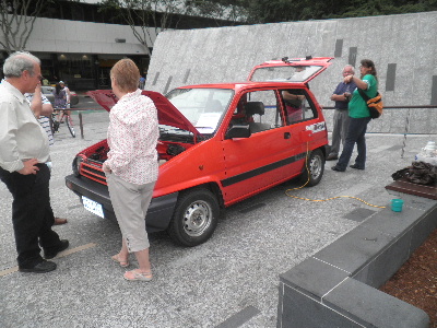

Another early start. Off we go to the car show. Back to the centre of Brisbane, King George Square. We were able to share what we know with many people during the day. It was great to also talk with others who had Electric vehicle displays of their own, learning from them too.

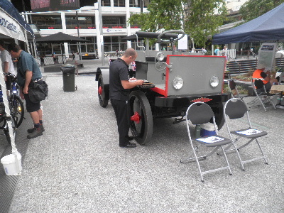

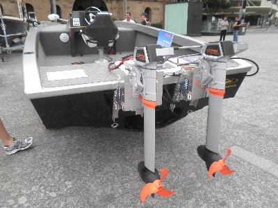

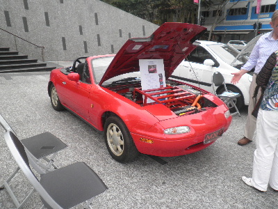

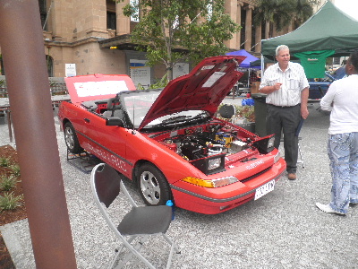

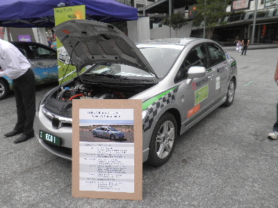

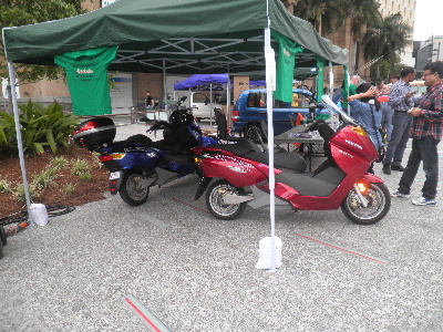

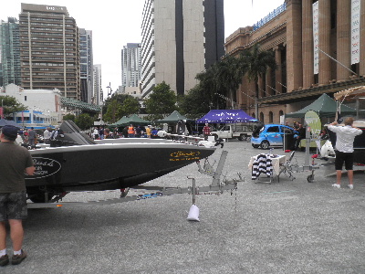

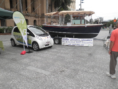

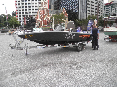

There were boats, scooters, push bikes, along with many cars. I did miss the Telsa roadster though. There was supposed to be one at the show, but I heard a rumor that the truck bringing it had broken down, so no Tesla. There was an old vintage electric truck, just to show that electric drive has been around for a long time. Some great work by many EV converters too. Graeme from Suzi Auto had a few of his cars there. It was great to see the Honda Civic with Ultramotive carbon motor and Tritium speed controller. The guy making the Prius plug in battery packs was there. I have a special interest in boats and so had to check out the carbon fibre 'Gold Rush' speed boat. Only 2 x 4kW Torqueedo motors and able to do 28km/hr.

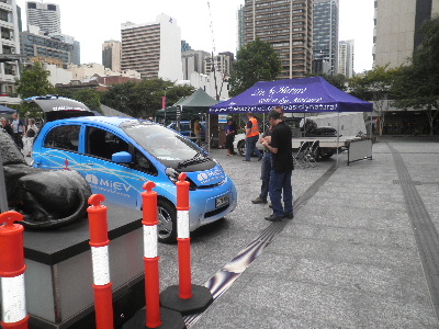

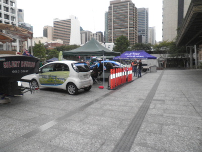

Here is a few shots around the show. We were next to Mitsibishi iMIEV and a charging station company on the other side of us.
