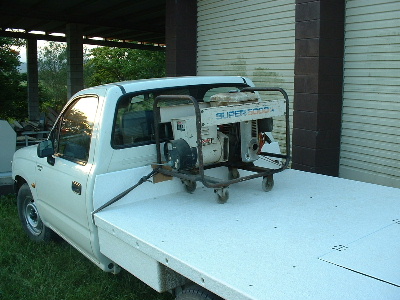

Tested a 5 KVA generator as range extender. Connected to the charger, there is only 15 amps delivered to the batteries. Rectified and connected direct to the batteries I was getting 23 amps. Not a lot of power considering the amp draw, 23 amps charging, and 200-250 amps discharging, but set out to see how it works. Had driven about 20 km and the brush holder melted and spat one of the brushes out. I will work on some other ideas / experiments that I have in mind. But I think the best solution is having a much lighter vehicle in the first place, so the amp draw is much less.

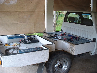

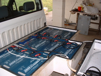

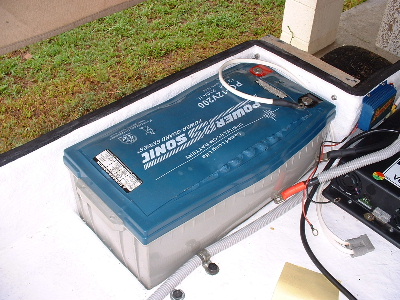

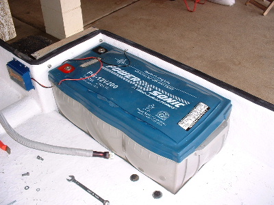

There is some battery problems. I had done about 50 km of driving and at the destination discovered that the 2 batteries in the rear box had become so hot that the plastic case had softened and swelled like footballs. The top is no longer sealed. The worst one was removed and replaced with the 13th one purchased at the same time. This swelled one is still working connected in with the wind and solar setup. The other swelled battery is still in the EV and still working.
I have emailed several times to the supplier and importer with no satisfactory answers why this has happened. They simply don’t know, but say it is likely to swell in charging. The swelling occurred in discharge while driving the vehicle.
I do not expect that these 2 swelled batteries will last very long, due to dry out. The batteries are just over 1 yr old with a 2 yr warranty and it appears that they are questioning and refusing to honor the warranty. I will no longer recommend these batteries as suitable for EV use, even though they still claim they are. There is no problem with the other 10 batteries all tightly packed together in the front box. To me, it seems to be a manufacturing fault. If they do honor the warranty I will make a posting to say so.
If any one has any clues why the heat and swelling, I would love to hear.

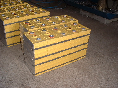

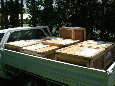

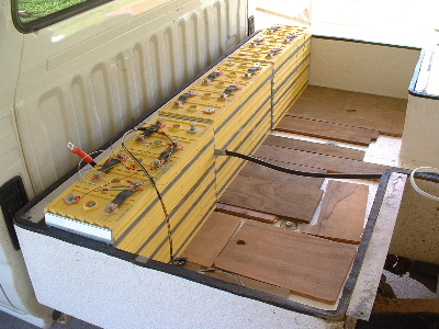

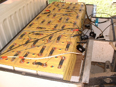

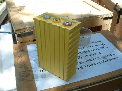

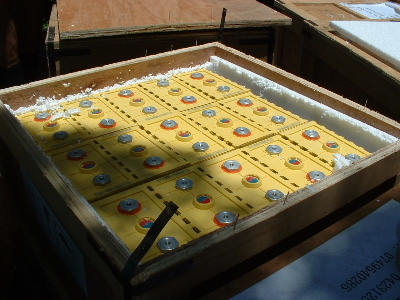

Thundersky Lithium cells are the latest addition to our product range. I have done some theoretical comparisons between wet cell, AGM, and Gel lead acid, with Lithium. Email me if you want a copy of these comparisons.
We have received the first order of Thundersky Lithium cells. Our pack is part of this order. I made a small error in not checking the input voltage to the charger. I had assumed the input was 240v single phase, but it is 380v 3 phase. So this one has to go back and they will sent another one. We will fit our Thundersky Lithium as soon as we recieve the other charger.
These cells are 3.2v nominal, so we have 45 cells in series to give the operating voltage of 144v nominal. Each cell is 200 a/hr. This is more useful electricity storage because there is no peukarts effect, like there is with lead acid.
Weight is only 7.6kg /cell x 45 = 342 kg. The AGM lead acid currently in use is 64 kg x 12 = 768 kg. A weight reduction of 768 - 342 = 426 kg.
We expect that our EV performance will greatly improve.

mmmmmmmmm ThunderSky
All the EV's I've seen to date that use the ThunderSky
LiOn's have been very succesful.
426Kg diet for the Toyota should help a lot. I'd love
to see a new set of test figures once this is done.
What is the specs for the single phase charger for the LiOn's?

I would also like to see your battery comparison. I am doing an EV conversion using a Geo Tracker (2WD) - a fairly small and lightweight vehicle. I am interested in seeing your battery comparison, as I am planning on using about 1100 lb (500 kg) of lead acid batteries.
Once question - how large are the Thundersky batteries? They look rather large, and in my vehicle, space is as much a concern as weight.

Your email is private in your member data, you can get my email from the website in the signature line at the bottom. Send me an email and then I will be able to send you the battery comparison info.
For battery sizing etc, look at the website and there you will find a link to Thundersky website with all the details of the cells. They are smaller and lighter than the lead acid.

Surprise surprise, it has now been 4 1/2 months, but I just received an email from Powersonic! They intend to send me 2 new batteries, under warranty!
We are still driving on the Powersonic batteries, even with one of the swelled batteries still in the pack.Edited by Trev 2008-04-01

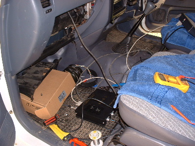

We have now fitted temporary the Thundersky Lithium batteries.
Initial charging is by the Zivan charger (used for the powersonic).

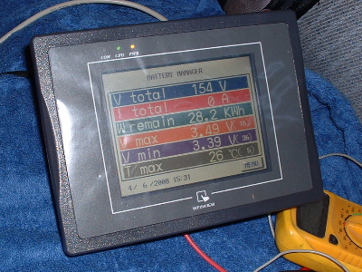

First drive did 40km using approx 10kw according to the screen.
After recharging again set out for max. distance driving at 80km/hr and achieved 140km using approx 25kw according to the screen.
That is double the range over the Powersonic AGM lead acid (70km, but with one swelled battery still in the pack.)
More testing and performance details later.

Some futher performance details of the Thundersky Lithium batteries.
Acceleration
0-60km/hr in 10 seconds
0-80km/hr in 18 seconds
0-100km/hr in 29 seconds
All measured on relatively flat ground. I am not happy with these tests, the vehicle is 420??kg lighter and it feels to accelerate quicker, but anyhow that’s the numbers measured.
Amp draw
at 60km/hr between 50-100amps
at 80km/hr between 120-150amp
at 100km/hr between 180-250amps.
Range
Have done 140km driving at 80km/hr using approx 25kw according to the screen.
Have done 93km driving at 100km/hr using 20kw, so should be able to drive 93km / 20kw x 25kw = 116km using 25kw.
This should still leave some capacity spare as the batteries are 200ah x 144v = 28.8kw
Cost
Driving 40km on 10kw is according to the BMS screen. Yes, Gordon this does make 10kw x $0.06 / 40km x 100km = $1.50 per 100km, but not correct due to the losses in the charging system etc. This is the same with driving 140km using approx 25kw.
Had driven 112km mostly at 100km/hr and used 24.5kw according to the screen. The Kw measured at the supply meter box was 37kw. Dollars then would be 37kw x $0.06 / 112km x 100km = $1.98 per 100km
Driven a total of approx 635km. These batteries have been sold and the new owner is using them in a 4wd, main application as an electric farm tractor.
These batteries are far superior to lead acid, even the speed controller can see the difference, it does not get as hot. I did not notice any thermal cut back at all. And its not that we now have cooler weather, after swapping back to the Powersonic, I have noticed the thermal cutback.
I have ordered another set of batteries and if anyone wants to get in on the same shipment, I can give a very good price. Economies of scale are very good with multiple orders in the same shipment. If anyone is interested, you will need to contact me asap.
I tested the big 60A 3phase charger at the local saw mill and it works very good. It can charge the battery pack in 3-5hrs from right empty. For those that don't have 3 phase power, the option is, Thundersky have granted the normal warranty on the bateries if we use Zivan NG3 (single phase) chargers, along with the Thundersky BMS.
I would not build another EV with lead acid! of any form.
