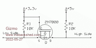

More progress. Definitely going for the ESP32 option now. There is a new port called FluidNC, written only for the ESP32. The code comes with its own installer, so you dont need the Arduino IDE. Once the code is installed, you edit up a config file to suit your machine, stuff like steps per mm, max speed, acceleration, GPIO pins for dir and step for each axis, etc. It has support for a whole bunch of CNC inputs and outputs, and there are dozens of sample config files to get you going. The config file is then uploaded via the USB serial interface using the FluitTerm program, or via wifi. The ESP32 sets up its own wifi hotspot, and you can log into a web interface on the ESP to upload the config file.
I'm using Universal Gcode Platform on my laptop to drive the ESP32 via USB. It basically just sends gcode commands over USB to the ESP32, which then does all the hard work.
So far I've got a basic config file sorted, enough to load up a gcode file, run it and flash LED's on the ESP pins configured for the axis.
My X & Z axis use M325 microsteppers, and the big Y axis motor is using a DM432C microstepper. These require TTL level logic, a HIGH is 4-5 volts, so I'll add some level shifters to up the 3.3 volts from teh ESP32. I've been using this simple level shifter circuit ( http://techref.massmind.org/techref/logic/levelconversion.htm )...
This weekend I'll grap some bits from Jaycar.
