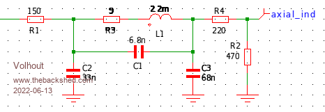

By removing the "standard" filter, plus two resistors and the little link block I found enough space to fit Volhout's circuit (including the 2.2mH inductors and two 5% capacitors) onto the (pretty crowded!) PicoGAME pcb. It doesn't take up all that much more board space really and needs no additional power supply filtering. I've changed other areas of the layout, but not to do with the audio. And I still haven't needed to stand resistors on end, and I've lengthened the distance between all the resistor holes by 1.7mm since version 1.4. :)

  Mixtel90 said  Volhout:
This is the inductor from RS.
Phil:
Useful tip...  Thanks.  :)
Mick,
The inductor you picked is a bigger one (body size) but can be used as wel.
For the best results with the RS inductor, use these values (theinductor you picked has higher Q factor, so it "peaks" more. Had to dampen it with capacitor values changes. With the 47n's it will also work, but with 33n/68n it is darn near perfect up to 18kHz.

Thanks, Volhout. Of course. if the RS component will fit so will a smaller one. That's a big plus.  :)
