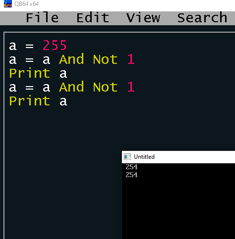

Example: I am expecting a=254
a=255
a=a and not 1 'just want to reset b0
print a
The result is zero

That's QB64
@matherp: That works! Cheers
Not in my DOS version though but it's not the latest.
