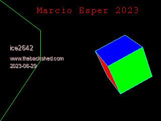

Posted: 12:45pm 29 Jun 2023
I am using here PicoMite VGA, and the framebuffer is working well, but I do not know if it is possible to create more layers.
[code]
CLS
FRAMEBUFFER create
FRAMEBUFFER layer
Dim float vertices(2,7)=(-1,1,-1, 1,1,-1, 1,-1,-1, -1,-1,-1, -1,1,1, 1,1,1, 1,-1,1, -1,-1,1)
Dim integer facecount(5)=(4,4,4,4,4,4)
Dim integer faces(23)=(0,1,2,3, 1,5,6,2, 0,4,5,1, 5,4,7,6, 2,6,7,3, 0,3,7,4)
Dim integer colours(6)=(RGB(red),RGB(green),RGB(red), RGB(blue), RGB(red), RGB(yellow), RGB(cyan))
Dim integer edge(5)=(6,6,6,6,6,6)
Dim integer fill(5)=(0,1,2,3,4,5)
Dim n=1,nv=8,nf=6,camera=1
Dim zz =1, zy=1,zx=1
Math scale vertices(),100.0,vertices()
Draw3D create n,nv,nf,camera,vertices(),facecount(),faces(),colours(),edge(),fill()
Dim integer viewplane=400
Draw3D CAMERA n,viewplane
Dim integer x=0,y=0,z=900
MODE 2,4
Font 3
FRAMEBUFFER write l
Draw3D show n,x,y,z
Dim float yaw=Rad(1),pitch=Rad(2),roll=Rad(0.5)
Dim float q(4)
Dim escala(5)=(132,148,165,175,198,247)
FRAMEBUFFER copy l,n
Math q_euler yaw,pitch,roll,q()
Draw3D rotate q(),n
Draw3D show n,x,y,z
Inc yaw, Rad(1)
Inc pich, Rad(2)
Inc roll, Rad(0.5)
Pause 1.3
x=x+zz
y=y+zy
z=z+zx
nota=nota+1
If nota> 5 Then nota = 1
Play tone escala(nota),0,100
Print @(10,10) " Marcio Esper 2023"
If x  > 270 Then zz = -1
If x < -270 Then zz = 1
If y > 110 Then zy=-1
If y < -140 Then zy =1
If z >3290 Then zx =-2
If z < 600 Then zx =1
[/code]
Best regards,
MMBasic 5.0707 on PicoMite VGA
