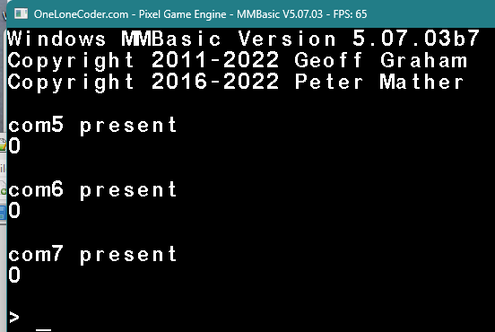

  Quote   A method of determining which port was allocated by Windows for that device would go a long way to making it viable. You don't want to have people having to use Device Manager to identify which port to open.
This snippit is all you need to scan for ports that are present.
 FOR n = 1 TO 32
   ON ERROR SKIP
   OPEN "com"+STR$(n)+":115200" AS #2
   IF MM.ERRNO THEN
     ' print mm.errmsg$
   ELSE
     PRINT "com"+STR$(n)+" present"
     'pause(100)
     test$ = INPUT$(20,#2)
     PRINT test$
     CLOSE #2
   ENDIF
 NEXT n
END
If your Wii emulator is running and spitting out data, there should be something recognisable in the buffer.
You can use that to work out which port is the one you want.
I put this on a pico
DO
PRINT "Hello Wii people"
PAUSE(10)
LOOP
and the results from the scan running in MMBasic for DOS was:
Windows MMBasic Ver 5.05.05
Copyright 2011-2021 Geoff Graham
com4 present
com5 present
com6 present
ople
Hello Wii peop
com7 present
com6 is the one we want.
Unfortunately, there seems to be a bug in MMB4W
I tried a number of different betas with the same result.
Bugger...

Thanks Jim, I tried that in MMBasic for DOS and MMB4W and the scanning code works well. I had no com ports used but plugged in my MM2 test/programming board and it was then found.
One way I thought of identifying the games port would be to first scan the ports and build an array of ports identified (just noughts and ones), have the user plug the device in, then rescan. The new device will be on the newly found com port.
The MMBasic for DOS response looks funny:
com6 present
ople
Hello Wii peop
com7 present
Was that some type of typo? or was that actually what you saw?
AHA! no you just got the end of one message and the beginning of the next.
An arcade type games controller would be easy to realize with an MM2, a serial to USB and a few buttons and resistors. A Wii interface could be even simpler if we could use the USB to simulate a keyboard.
But first the bug needs squashing.

On  MMB4W you can you the function comport(n) to test if a port exists without using the abomination that is "on error"

  matherp said  On  MMB4W you can you the function comport(n) to test if a port exists without using the abomination that is "on error"
Thank you Peter, this works:
FOR n = 1 TO 32
   if Comport(n) then
   ENDIF
 NEXT n
END
I have not updated to the latest MMB4W yet.
Turbo46
Joined: 24/12/2017
Posts: 1694
Posted: 05:05am 21 Dec 2023
For interest sake:
If I have Teraterm connected to a 'mite and run the program:
FOR n = 1 TO 32
  ON ERROR SKIP
  OPEN "com"+STR$(n)+":38400" AS #2
  IF MM.ERRNO THEN
  ELSE
    PRINT test$
    CLOSE #2
  ENDIF
NEXT n
END
Does not detect the port but it does if I close down Teraterm though.
The program:
FOR n = 1 TO 32
  if Comport(n) then
  ENDIF
NEXT n
END
method does detect the port whether the port is active or not.
So the ON ERROR method may still be useful for detecting a device plugged in but not yet in use.
