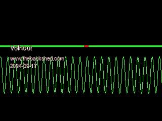

Just to demonstrate how usefull PSRAM can be
PicoMiteVGA for the RP2350
This is a demo to sample 100000 ADC samples (800kbyte data) stored in PSRAM.
The cursor keys let you zoom through the data.
Just apply an input signal to GP26. The scope samples at 100kHz, and takes 100k samples, so capturing takes 1 second.
The red section in the green bar shows what piece of data is shown.

Again nothing fancy, only a demo to show deep memory using PSRAM on the PGA2350 or Pico2-plus. You must enable PSRAM using OPTION PSRAM PIN GP47.
Theoratically it is possible to use all PSRAM, and store 1 million samples. I did not try that.
