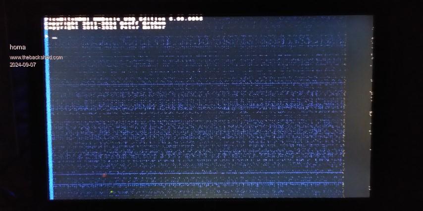

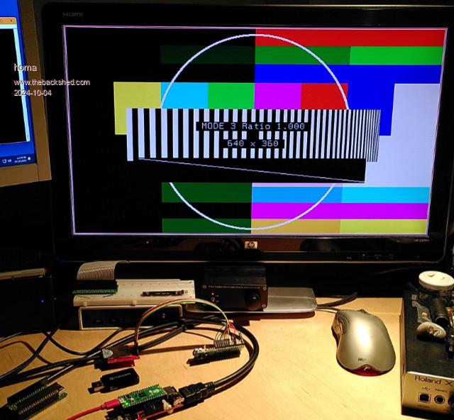

Hi, my problem with HDMI output was not as bad as in this picture with one of the last FW versions:
https://www.thebackshed.com/forum/ViewTopic.php?TID=17229&P=1#226154
But my monitor (HP 2309m) also delivers with the
> option list
PicoMiteHDMI MMBasic Version 6.00.00RC3
OPTION FLASH SIZE 4194304
OPTION COLORCODE ON
OPTION KEYBOARD GR
OPTION CPUSPEED (KHz) 372000
OPTION DISPLAY 30, 80
OPTION HDMI PINS 1, 3, 7, 5
OPTION RESOLUTION 1280x720
OPTION SDCARD GP22, GP6, GP7, GP4
OPTION AUDIO GP26,GP27', ON PWM CHANNEL 5
OPTION MODBUFF ENABLE 192
OPTION PLATFORM OLIMEX
OPTION DEFAULT FONT 3, 1
no permanent image. A resync takes place every few seconds to minutes. Including slight crisping on the left edge.

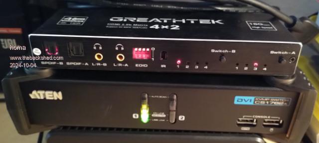

But I also wanted to use my HDMI matrix:
https://www.thebackshed.com/forum/ViewTopic.php?TID=17173&P=6#225723
By the way, the HDMI/DVI signal only works with a direct connection to the monitor. Using an HDMI matrix (Greathtek 4x2) does not work.
I bought this DVI switch: Aten CS1762A.
What can I say? It works better than expected. Not only can I use the DVI input from the monitor, I can also use the HDMI matrix! I found this device in a small ads. For a fraction of the new price and as unused goods.
I hope this can help someone.
