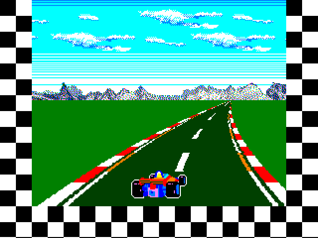

Martin H.
Joined: 04/06/2022
Posts: 1570
Posted: 10:46am 22 Mar 2026
Since it's Sunday,
I dug up some old code and sped things up using the new BLIT RESIZE command
On the PICO2 HDMI @252MHz, this gives me 47 FPS, so there's now room to include enemie cars, trees, and signs
Road.zip
Have Fun
Martin
Link to the original post

Peter63
Joined: 28/07/2017
Location: Sweden
Posts: 217
Posted: 02:37pm 03 Apr 2026
  Quote  Road.zip
Have Fun
Martin
have tried it on,  PicoMiteVGA MMBasic USB RP2040 Edition V6.02.01
