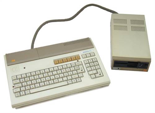

Hi,
I run programs within my menu system that I wrote way back when my mother taught me Basic (almost 30 years ago. the program was called System 2000, and all of our family's software was run thought is menu system, even giving you instructions on which disk to enter and into which drive to put the disk. upon exiting the chosen program the menu system would pop back up for your next choice. the original program was written on a legal pad and was over 20 pages long, then transferred to the PC). The PC was a Trimph Adler alphtronic PC.
Here is some of the code.
2210: GOTO 2000
2300: RUN "HAMURABI.BAS"
2400: RUN "CHECKER.BAS"
2500: RUN "MMPREY.BAS"
2600: RUN "MMFOUR.BAS"
2700: RUN "HIGHIQ.BAS"
2800: RUN "STAR.BAS"
Then i have edited the quit function of the above programs to run my menu system when you chose to quit/exit the program.
I've never had problems with any version of MM Basic running my program.
Matt
