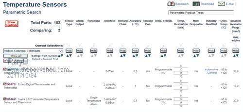

Further to Keith W and CrackerJack's posts here is a comparison between DS18B20 (1-Wire Device) and DS1721 and DS1621 (2-Wire/I2C devices)
Keith W (or anyone else) would it be correct to assume that the sample code above would not work with a 1-Wire Device like the DS18B20 which I just happen to have and not the other I2C components.

Hi Ray
I wasn't able to read the image you posted ... could you redo it as a URL.
I have included the following link which gives basic info on the alternatives to I2C.
http://www.i2c-bus.org/alternatives/
With the little that I know I would say that 1-Wire's software requirements are more demanding then I2C mainly due to the strict timing demands.
Horses for courses ... Clydesdales will never win the Melbourne Cup but will pull more weight then a spindly filly. Equally 1-Wire has advantages over I2C.

Posted: 01:01am 25 Oct 2011
Keith @ I've reposted the comparison off the MAXIM web page below as it shows some differences. This is a filtered page which can't really be sent as a URL due to the filters not showing up but here goes....http://para.maxim-ic.com/en/results.mvp?fam=temp_sen s
My preference for the DS18B20 because I have those at hand from using them with PicAxe and the fact that I can buy 10 for A$14 from HongKong on ebay inc post (takes 2 weeks). Someone mentioned DS1621 on special at 50 cents each from Rockerby but their freight alone in Aussie is over $10.
Much a muchness I suppose...
