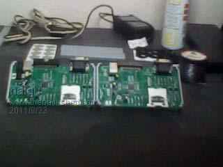

Posted: 06:02pm 22 Aug 2011
Finally got enough parts together to build up those PCBs tonight. Haven't had so much fun in years! I'm still missing the 100nF caps, 8MHz crystals and PS2 sockets but they've been on their way from China for about 3 weeks so should arrive by Friday.
One unit is going to be stock standard with MMBASIC and the original case, the other is for playing around with. I'd post a proud photo of my handiwork but the darned phone/camera battery is flat again.
Rob
edit: Couldn't resist, I charged it up...
Edited by haiqu 2011-08-24
