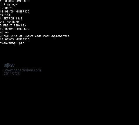

I have had a play with reading a pin set as a open collector but the Maximite is giving an error when trying to read the pin "...Input mode not implemented"
Pin 19 has a pull up resistor on it. I was expecting a read of 0 with this example.
Should this be done another way?
Please see the screen shot below.
Anthony.
Posts: 3369
Posted: 10:05am 23 Jul 2011
  ajkw said  Should this be done another way?
No, that should work. Sounds like a bug... and I thought that I had properly tested that!

OK, a new test version (2.4C) which fixes the bug reported by Anthony.
It can be downloaded from: http://geoffg.net/Downloads/Maximite/Maximite_Update_V2.4C.z ip
Thanks Anthony,

Geoff,
Yes all fixed in 2.4C. Thanks.
Anthony.
