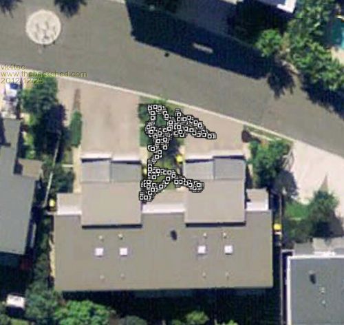

GPS wander

That gps wander is actually pretty good, i have seen a lot worse.
May times it get worse when you park close to a wall (at least 45% of the sky obscured) or in a street with tall buildings you get problems because of canyoning. Edited by TZAdvantage 2012-12-26
