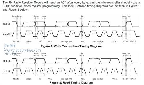

The timming is as this pic
So i have the following
