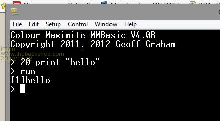

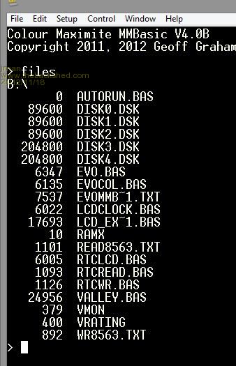

If I boot the UBW with a sd card installed and a blank autorun file ie file size is 0 bytes
I get the following error as seen in the screen shots
Notice the [1]

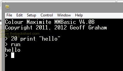

Same device below started with no autorun file present on the sd but the sd card inserted

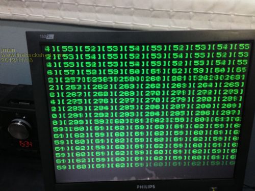

If I load a program after booting off with the autorun file present I get lots of number in square brackets on the display instead of the expected output.
Run the same program without a autorun file present and it works as expected.

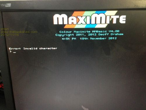

Randomly I get a "invalid character" at boot time just above the > cursor
Only one of the UBW32's has this problem and problem exists if I change Micks board so it is definitely on the UBW32

I think it is in trace mode. Try trace off and see if that helps

Winner I turned trace mode off and now the display is normal
but after reboot trace mode is on again
The odd part this only happens when I boot the UBW with an sd card inserted

the autorun file is empty zero bytes
I make it go if I remove the autorun file but I just thought it was odd

It definitely looks like it powers up with TRON enabled...
Are you saying (it wasnt quite clear on this point) that if you DELETE the autorun.bas file then all is fine?
If so the answer is dont use a `null' autorun file.. if it still plays up try shorting across R12 (2R2 ohm) with a wire link as maybe the SD is drawing a bit too much current and corrupts it a bit.. It could be on the limit of working which is why one works but not the other.

Yip if I delete the autorun file then it power up with trace mode off
If I set the autorun to run a file on the sd card it will power up in trace mode
50% of the time
