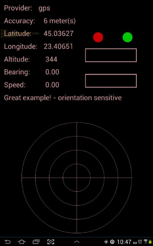

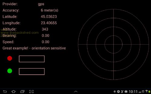

So, I wanted to see if BASIC! can be a capable tool. I wanted to learn how to use the graphics, touch events, orientation screen sensitive apps, and "bluetooth" communications. And I ended up with this little program, starting from the existing examples
The text data is from GPS "sensor" (one of the given examples), the red LED will go ON/OFF if you touch the rectangular zone from his right (or bellow) and will toogle also a LED from your microcontroller board sending "0" for off and "1" for on. The green LED will signal the bluetooth status and the "button" assignated to it will close the bluetooth communication and the program. Tha radar thing does nothing, only redraws depending on the screen orientation - just to play with relative coordinates.
The way I draw the graphics (clear the screen and redraw everything at every 10 ms) is not the best method but is one of the two possible and it came with the GPS example. Anyway, avoid screen orientation sensitive applications if you have to make realtime graphs, stick with Landscape or Portrait.
Application will not start (well, I've not tested all the cases) if you don't have the Bluetooth module paired, so, if you still want to test the program, comment every command which starts with "bt." (or "BT.", doesn't matter, is not case sensitive) sequence.
Entire program can be written in a better way, you will see when you read the code but, is a start. Unfortunately, the relative coordinates thing make it relatively () hard to "decrypt" ....
To be honest, the language is good, but ... don't quite like it and is hard to write real applications on small Android devices, even if there is a real keyboard, the Android applications does not respond to a full category of events, as on PC. But is a nice and capable enough tool (I bet it can become quite "dangerous" in a BASIC programmer hands). I read in the documentation that you can make HTML+CSS user interfaces, and that will be great... don't know yet how to do that...
