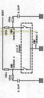

I debounced it this way:
If you don't rotate to fast it is ok.

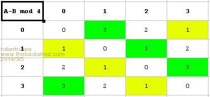

and what does MMbasic produce as the result of "(-1) MOD 4"? the result of MOD on negative numbers should be as follows:
(-1) mod 4 = 3
(-3) mod 4 = 1
Edited by robert.rozee 2014-03-06

btw, the logic i used was based upon the following map:
green and yellow represent the two different directions of rotation, while white cells are the 'illegal' states where a transition has been skipped.
Posted: 08:33pm 04 Mar 2014
the problem with 'illegal states' is what you are going to do with them.
From that moment the counter is wrong and there is no way to fix it.
In software you can not fix illegal states caused by contact bounce or any other reasons.
The solution is in hardware like better encoders and debouncing, optical would be great.
It is the reason why i ignored the Gray encoding.
It makes things slower and more complicated.
