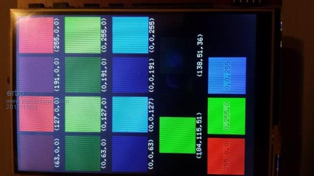

Hopefully this is something Matherp can comment on.
I have one of the 4" 320 x 480 IPS ILI9481 screens on an E28 Micromite using the loadable driver for MM2 provided by Peter in this thread. I am getting weird results with the colors being displayed on the screen, sometimes the color displayed is nothing like what it should have been - e.g. bright green instead of a light tan! I only have one of these screens so can't try another to see if maybe the screen is defective, but it does seem to do everything else correctly.
I have created a small test program that displays samples of various colors (which illustrates the problem) and I have run this program on a 7" SSD1963 connected to an E64 and the colors displayed are as I expected them to be - see example screen images below for comparison.
Below is the ILI9481 screen image:

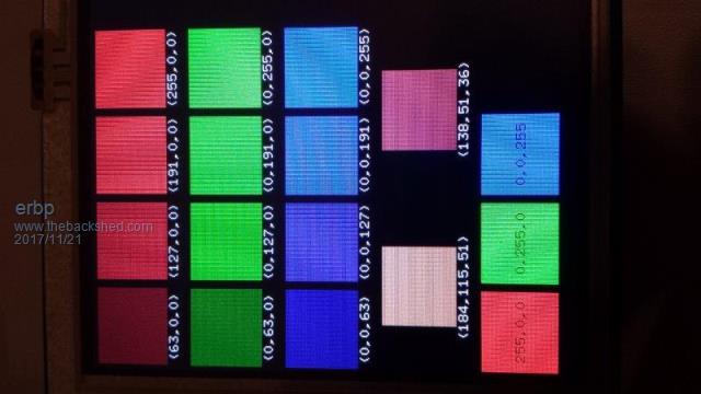

And the next one is for the 7" SSD1963 screen:
Some of the colors change a bit from what they looked like on the screens to the naked eye, but not so much that tan turns to green or copper turns to black (4th row across, top image)
Below is the code for the program producing these images - maybe if someone else has one of these screens working they could try the program and advise if they get the same results as I did or if the result is more like the second image above (i.e. correct).

Also notice in the righthand row of the first image, there is text overlaying the 3 color boxes. The text is specified with the same color as the box was filled with, yet it displays as a different shade to the background of the box. This is more noticeable with the Blue in the image, but in reality the Green one was particularly noticeable (that seems to have got lost somewhere in the photo taking / transferring process). In the second image there is no discernible difference between the box background and the text background, as it should be.
At present I'm not sure if it is just my screen or whether there is a problem with the MM2 version of the driver.

Hi Phil
It is working for me but it is sensitive to wiring as the SPI is running very fast (I'm testing on a MM2 HAT stand) . You can try setting the CPU speed to 20 to see if that changes things. Also the attached version has an optional speed setting parameter
ILI9481 CDpin, RESETpin, CHIPSELECTpin, orientation, speed
The speed parameter changes the SPI clock divider. Without the parameter the SPI bus runs at the CPU speed / 2
Setting a value changes the SPI speed as follows "SPI speed=CPU speed / 2 /(speed+1)"
