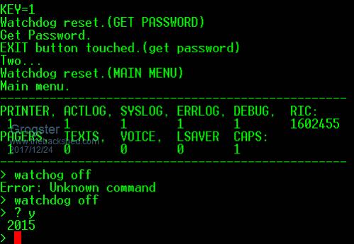

If I change the PRINT Y's to "One" and "Two" like this:
  Quote   Endif
Endif
If Y Then EXIT Do
If Timer>=SSDELAY Then goto START
LOOP
Print "One..."
Print "Two..."
ON Y goto START,DATABASE_EDITOR
I get the following output on the console:
....note how the code is NOT printing the "One..." line, but it IS printing the "Two..." line.
This also takes me back to the main menu. If I CTRL-C at that point, and ask the console for PRINT Y, it gives it back as 2015, which it most certainly should not be.
Y can only ever be zero, one, two or three to satisfy the ON commands.
If I reflash MMBASIC 5.04.05 and load exactly the same code - no problems, everything works as it should.
Bizarre.
Y is apparently getting changed by something, but it does not get changed by earlier firmware, but the latest firmware DOES change Y somehow, some way.
BUT, if you put in some print statements, Y stays as it should, and the ON command works fine. Really scratching my head at this point....
I know WHY the ON command is passing right through to the database entries routine when you touch EXIT, because with Y being 2015 or so, it is taking the last of the routine labels it can find in the ON command, and hopping to there, but that should never happen, as when you touch the EXIT button, Y is set to 1, then the routine hops out of the loop, and runs the ON command. As Y is set to one, it runs the START routine, which takes it back to the main menu. As I say, all that was working just fine.

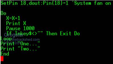

UPDATE:
Here is some demo code:
RESULTS:
The result is that "Two..." is printed, and "One..." is totally ignored.
Seems to be that the first line following the LOOP command, is being skipped?

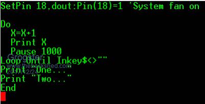

EDIT: It's related to the EXIT DO command.
If I remove the If Inkey$<>"" Then Exit Do line, and change the LOOP line to read Loop Until Inkey$<>"", then the code works!
Therefore, in my original code posted above, the interpreter is not seeing or otherwise not executing the ON command at all(because it is right after the LOOP command) - and just starts running the next routine below it, which is the database editor routines....Edited by Grogster 2017-12-25
