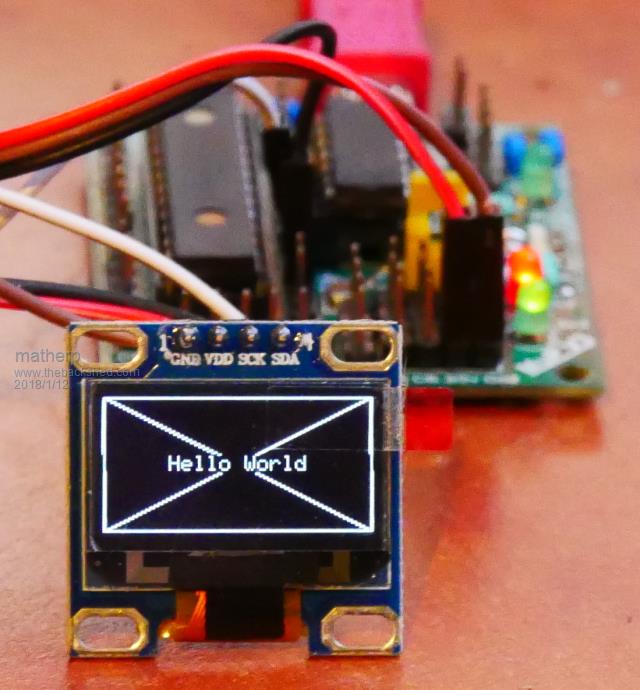

This is all best illustrated by looking a Basic display driver for one of the SSD1306 OLEDs, in this case driven over an I2C bus with just a two wire connection.
I've tried to comment this as much as possible. The complexity is always in converting the simple drawing instruction to draw a rectangle or bitmap into the required sequence to implement this on any specific type of display
if you write your own display drivers please add to this thread

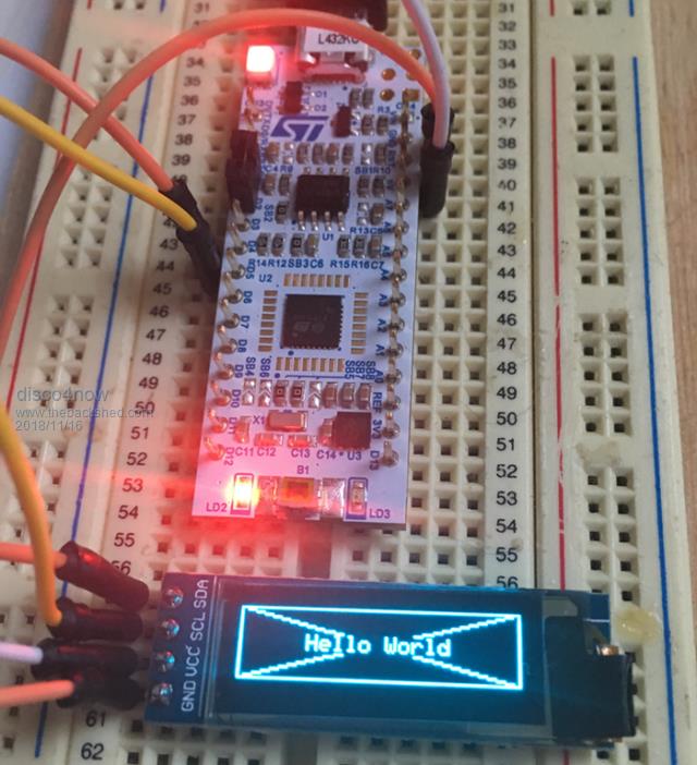

Driver for 0.91" SSD3306 128*32
I created a driver for this display based on Peters code above.
This is the LCD. SSD3306 I2C 128*32 Banggood
The changes are.
OPTION LCDPANEL USER,128,32
During initialization two changes:
OLED.SCmd(&HA8)'MULTIPLEX
'OLED.SCmd(&H3F)' 3F required for 128x64 display
OLED.SCmd(&H1F)' 1F required for 128x32 display
OLED.SCmd(&HDA)'COMPINS
'OLED.SCmd(&H12)'12 for 128*64
OLED.SCmd(&H02)'02 for 128*32
The buffer required is only half the size so
for i% = 0 to 3 'was 0 to 7
s$(i%)=string$(128,chr$(0))
next i%
'https://www.banggood.com/0_91-Inch-128x32-IIC-I2C-Blue-OLED-LCD-Display-DIY-Oled-Module-SSD1306-Driver-IC-D C-3_3V-5V-p-1140506.html?cur_warehouse=CN
on error skip 'if OPTION is already set then ignore the error
OPTION LCDPANEL USER, 128,32
userdisplayinit
line 0,0,mm.hres-1,mm.vres-1
line mm.hres-1,0,0,mm.vres-1
box 0,0,mm.hres,mm.vres
text mm.hres/2,mm.vres/2,"Hello World",CM,8
end
sub userdisplayinit
' The 0.91" SSD1306 display is 128 x 32 monochrome pixels
' This is arranged as 128 bytes x 4 bytes so a byte will cover the pixels in 8 rows of the display
' this makes it a bit tricky to program as we have to remember what is in the other 7 rows if we want to update a pixel in any specific row
' In this example we will hold a display image in a string array with 8 elements each 128 bytes long
OPTION explicit
OPTION default none
on error skip 'if global variabels aren't yet set ignore the error
erase S$(), tmaskarray(), bmaskarray()
DIM S$(3) length 128 'this is the array that stores the screen image
DIM integer tmaskarray(7)=(255,254,252,248,240,224,192,128) ' mask for writing pixels left to right
DIM integer bmaskarray(7)=(1,3,7,15,31,63,127,255) 'mask for pixels right to left
local i%
on error skip ' if I2C already open ignore the error
i2c open 400,1000
' send the intialisation instructions to the display
OLED.SCmd(&HAE)'DISPLAYOFF)
OLED.SCmd(&HD5)'DISPLAYCLOCKDIV
OLED.SCmd(&H80)'the suggested ratio &H80
OLED.SCmd(
&HA8)'MULTIPLEX
OLED.SCmd(
&HD3)'DISPLAYOFFSET
OLED.SCmd(&H0)'no offset
OLED.SCmd(
&H40)'STARTLINE
OLED.SCmd(
&H8D)'CHARGEPUMP
OLED.SCmd(&H14)
OLED.SCmd(
&H20)'MEMORYMODE
OLED.SCmd(&H00)'&H0 act like ks0108 Horizontal Address Mode
OLED.SCmd(
&HA1)'SEGREMAP OR 1 A0 for Reverse direction
OLED.SCmd(
&HC8)'COMSCANDEC C0 for Reverse Landscape
OLED.SCmd(
&HDA)'COMPINS
OLED.SCmd(
&H81)'SETCONTRAST
OLED.SCmd(&HCF) 'CF
OLED.SCmd(
&Hd9)'SETPRECHARGE
OLED.SCmd(&HF1)
OLED.SCmd(
&HDB)'VCOMDETECT
OLED.SCmd(&H40)
OLED.SCmd(
&HA4)'DISPLAYALLON_RESUME
OLED.SCmd(&HA6)'NORMALDISPLAY
OLED.SCmd(&HAF)'DISPLAYON
' Set the memory image of the display to all zeroes
for i% = 0 to 3
s$(i%)=
next i%
' Refresh the display with the new blank image
update 0, 0, mm.hres-1, mm.vres\8 -1
end sub

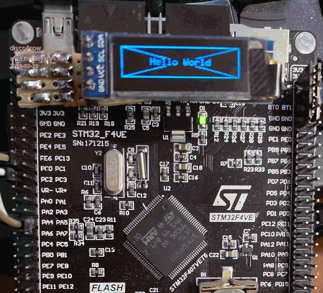

Again to confirm that the ARMMITE F4 does support user defined LCDPanels written in MMBasic.
This driver from memory has a little glitch, if you attempt to display a right justified text, that uses the scale option in the text command and it results in the text being beyond the x=0 co-ordinate it breaks.Fixing this is an exercise left for the reader.
The NRF socket has 3.3v, GND and the I2C-SCL and I2C-SDA pins available and is the ideal place to connect the i2C display.

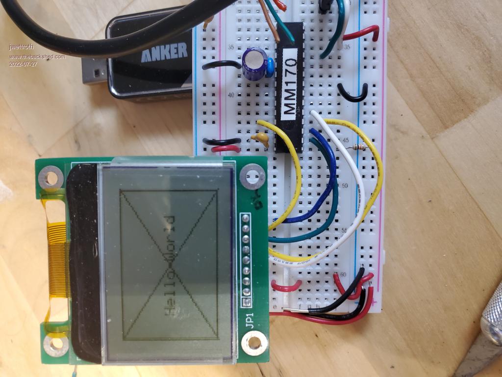

New User Basic LCD driver for SED1565 and similar mono LCD's.
The code below and photo is a LCDPANE User driver for a 100 x 64 pixel mono LCD based on the SED1565 driver.  This driver is similar to the UC1609 Mono LCD driver.  Its a very low power SPI display driver with onboard charge pumps, for operation from 2.7 to 5.5v.  Supply current is about .35 mA active.  I have a bunch of these displays from an old project and thought getting them to talk to the MMITE would be a nice challenge.  The code here is heavily cribbed from the SSD1306 OLED display.  These displays have a similar layout and pretty minor changes were require- explained in the code.
'SED1565 LCD DRIVER TEST CODE
'  THIS IS A USER LCDPANEL DRIVER FOR DISPLAYS USING THE EPSON SED1565 AND
'  COMPATIBLE (UC1609).  THESE ARE MONOCHROME LCD DRIVERS.  THE PARTICULAR
'  DISPLAY HERE IS 100 X 64.  THERE IS AN 8X13 FONT EMBEDDED.  ALL SEEMS TO
'  WORK THOUGH IT IS QUITE SLOW.
'Wettroth 7/1//22
'  Started with a ssd1306 OLED driver that has a similar memory layout but
'  different init routine, minor syntax diffs and is SPI vs I2C.  The syntax
'  diff is that the OLED display or'ed data with 40 hex.
'BEGIN
'Pins
'Connections Display on SPI- EBLCD Board
'DIN  3 DOUT  <DS PIN 8> SPI OUT
'SCL  7 DOUT  <DS PIN 7> SPI CLK
'CS   5 DOUT  <DS PIN 4> ACT HI
'A0   2 DOUT  <DS PIN 6> GPIO
'RST  4 DOUT  <DS PIN 5> GPIO
'ARCHIVED AS REV1
'REV 2-
'Basic Test Code *****************
userdisplayinit       'init display
'Standard User Display Test
Line 0,0,MM.HRes-1,MM.VRes-1
Line MM.HRes-1,0,0,MM.VRes-1
Box 0,0,MM.HRes-1,MM.VRes-1
Text MM.HRes/2,MM.VRes/2,"Hello World","CM",8
End
'basic end- driver code follows

John Wettroth
athlon1900
Joined: 10/10/2019
Location: Austria
Posts: 49
Posted: 02:26am 27 Jul 2022
  jwettroth said  New User Basic LCD driver for SED1565 and similar mono LCD's.
Many thanks , good job
