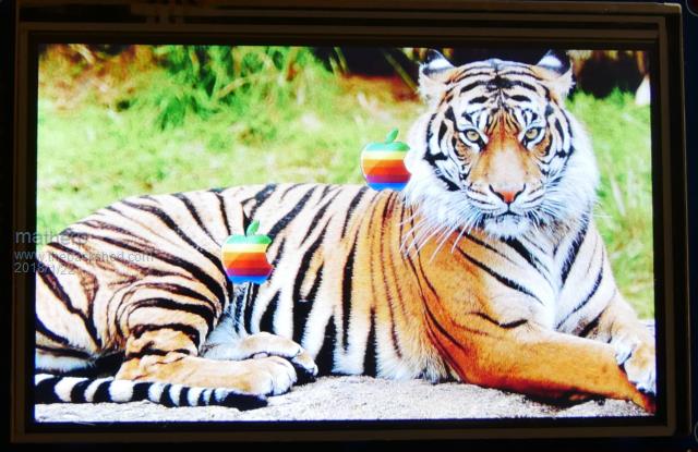

This release plays with some ideas for Sprites building on the existing BLIT functionality which has also been slightly simplified/improved. Sprites are full colour and of any size and shape. SPRITE/BLIT images can be displayed partially off the screen, this was not previously the case for BLIT on the MMX, and I believe the MM+, where partially off screen images were corrupted.
The commands and function SPRITE and BLIT can be used interchangeably
NEW FUNCTIONALITY
SPRITE LOAD
A new option in BLIT/SPRITE is added to directly load a .PNG file from the SDcard. PNG files are the standard for sprites in CSS and it seemed to make sense to allow the Micromite to load them directly
2018-01-22_034650_apple.zip

The code for a very simple demo is attached
Option explicit
option default NONE
dim integer i
DIM INTEGER iw, ih
' load sprite
BLIT LOAD #1,"apple"
BLIT LOAD #2,"apple"
iw=BLIT(#1, W)
ih=BLIT(#1, H)
'create a background
load image "tiger800"
dim n%,m%, x1%=rnd()*(mm.hres-iw), y1%=rnd()*(mm.vres-ih), x2%=rnd()*(mm.hres-iw), y2%=rnd()*(mm.vres-ih)
dim x1o%=-1, x2o%=1, y1o%=-1, y2o%=1
dim s%=8
blit show 1, x1%,y1%
blit show 2, x2%,y2%
do
do
x1%=x1%+CINT(rnd()*s%-s%\2+s%\2*x1o%)
y1%=y1%+CINT(rnd()*s%-s%\2+s%\2*y1o%)
if x1%>=mm.hres then
x1%=mm.hres
x1o%=-1
endif
if y1%>=mm.vres then
y1%=mm.vres
y1o%=-1
endif
if x1%<=0-iw then
x1%=0-iw
x1o%=1
endif
if y1%<=0-ih then
y1%=0-ih
y1o%=1
endif
loop until collision%()=0
do
x2%=x2%+CINT(rnd()*s%-s%\2+s%\2*x2o%)
y2%=y2%+CINT(rnd()*s%-s%\2+s%\2*y2o%)
if x2%>=mm.hres then
x2%=mm.hres
x2o%=-1
endif
if y2%>=mm.vres then
y2%=mm.vres
y2o%=-1
endif
if x2%<=0-iw then
x2%=0-iw
x2o%=1
endif
if y2%<=0-ih then
y2%=0-ih
y2o%=1
endif
pause 250
loop
function collision%()
collision%=1
if x1%+iw<x2% OR x1%>x2%+iw OR y1%+ih<y2% OR y1%>y2%+ih then collision%=0
end function
