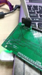

  Quote  When you say "I changed the CON8 power connection to CON1", are you connecting ONLY 5V and GND to CON1?
Tx and Rx also connected. Refer image below.
  Quote  how are you connecting the Micromite to the PC in this configuration?
Initially, I use CON8 as power and I fit JP1. Then, I changed to CON1 as power and CON8 for transferring data. The problem is I forgot to remove JP1 for my second connection!
