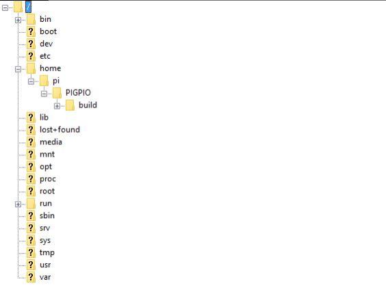

I've got Pi running on the board I made to interface with the SSD1963 LCD
I can talk to it through a USB cable, or via WiFi with no issues
Where do I put the mmbasic program and the actual program to run on the Pi and also any images to use?
This is my folder tree - I used FileZilla to FTP to the PI
but Putty also works fine
I did ask before on another thread where to put images and I was told I believe the root folder but I'm not sure what that means
Is the the root folder you can see on Windows when you look at the card with an SD Cardreader?
Or is it the folder named Pi?
or another folder?

You should use the PWM jumper on the display.
An mmbasic directory under home/pi directory is where the mmbasic file can go.
I have put and img directory under that to put images in, just to keep it tidy. Just need prefix "img/" to the file name so its found from MMbasic
LOAD IMAGE "img/"+JSON$(a(),"daily.data[5].icon"),0,268
I also have a file called mm in the home/pi directory with contents:
cd mmbasic
sudo ./mmbasic
So to start mmbasic it is just
./mm
