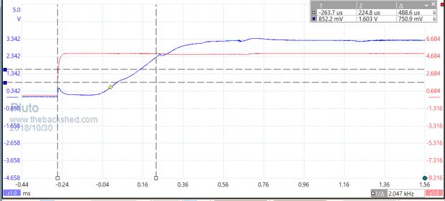

Pluto
Joined: 09/06/2017
Location: Finland
Posts: 417
Posted: 10:40am 30 Oct 2018
In addition to my earlier post.
Blue trace: 3.3V powerline for PIC
Red trace: USB powerline
time scale in ms.
Vertical cursors: 1) Connecting USB, 2) PIC's power at 2.3V (min operation voltage for PIC). 488.6 us before we have 2.3V.

Posted: 11:42am 30 Oct 2018
Pluto
I am interested in your recording 'device' can you give some details about your recorder?
Pluto
Joined: 09/06/2017
Location: Finland
Posts: 417
Posted: 01:13pm 30 Oct 2018
It is a PICOSCOPE 3224. 2 channel 10MHz oscilloscope. USB connected. Useful also for decoding I2C and SPI.
