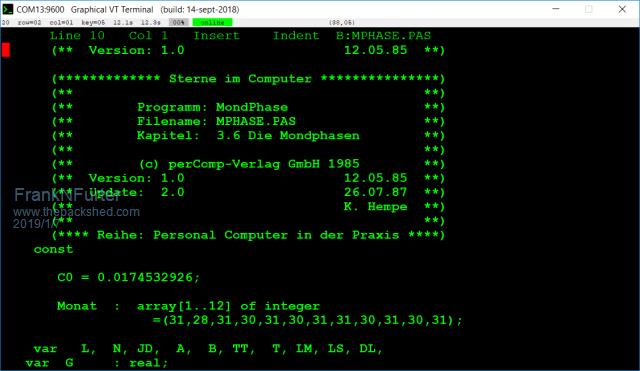

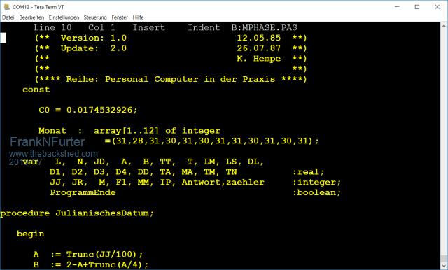

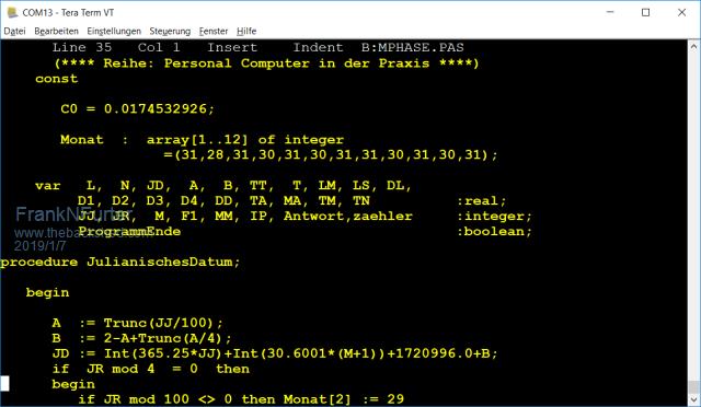

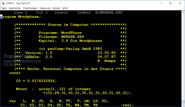

I have great pleasure with my small Z80 computer (Z80-MBC2 - many thanks to Jman!) but a VT100 problem with GFXterm, Geoff's - ASCII Video Terminal and TurboPascal 3.0!
As an example, my moon phases program:
All works great with Teraterm, but unfortunately not with Geoff's Terminal and not with GFXterm.
When I start the editor, everything seems to be normal:
...but when I scroll down:

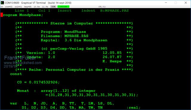

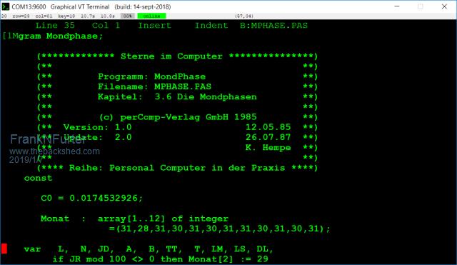

...only the last line is updated! When I scroll back
only the first line is updated!!!
What's going on? Unfortunately it looks the same on an external monitor with Geoff's VT100 terminal!

right, i think i've found the reason things are going wrong:
<ESC>[02;01H // cursor position, row 2, column 1
<ESC>[1M // (***) delete current line, scroll screen up
<ESC>[24;01H // cursor position, row 24, column 1
<ESC>[1m // select BOLD text
ProgrammEnde :boolean;
<ESC>[K // erase to end of line
<ESC>[23;01H // cursor position, row 23, column 1
<ESC>[01;12H // cursor position, row 1, column 12
<ESC>[0m // select NORMAL text
24
turbo pascal is using <esc>[1M to erase the top line of the text area and scroll up the screen - this is a VT102 eacape sequence not supported by GFXterm or geoff's VT100 terminal.
