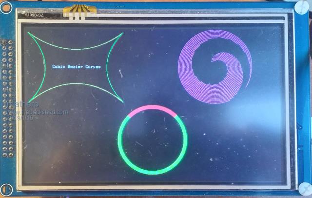

Please find attached V5.05.03
2019-01-10_194559_Armmite1.3.zip
2019-01-10_194625_Armmite_H7_Manual.pdf
This includes arc and Bezier curve drawing commands as per my recently listed CFunctions. Command syntax in the manual. It also removes the restriction on arrays having dimensions > 32767 elements
CLS
bezier 10,10,106,80,212,80,309,10,rgb(yellow)
bezier 10,230,106,150,212,150,309,230,rgb(yellow)
bezier 10,10,80,80,80,160,10,230,rgb(green)
bezier 309,10,239,80,239,160,309,230,rgb(green)
text 85,110,"Cubic Bezier Curves"
for i=0 to 99 step 4
Arc 600,120,20+i,,325+2*i,5+5*i,rgb(magenta)
next i
arc mm.hres\2,350,100,110,315,45,rgb(red)
arc mm.hres\2,350,100,110,45,315,rgb(green)

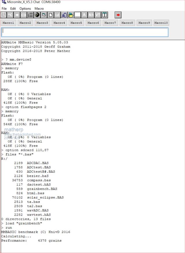

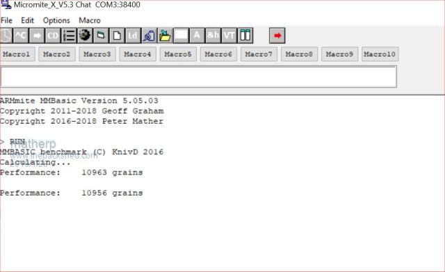

Big performance improvement for programs with strings or arrays and re-write of serial processing to fix bug and improve performance. It transpires STM32 chips hate non-aligned data (i.e. an integer should be on a 4-byte boundary). Performance on this benchmark is now much greater than 2x MMX and nearly 5x MM+ at 100MHz.
2019-01-28_043616_Armmite1.3.zip
Coming soon port for STM32F767ZI (since I had one and wanted to evaluate how portable STM32 code really is)
