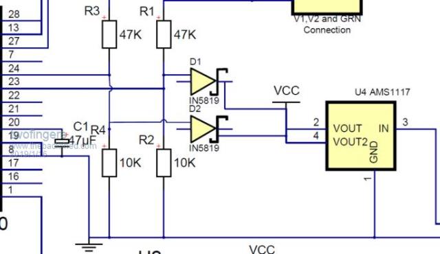

Thanks for the link for the schematic. I get the resistor network, but what do the diodes actually do in this case? I apologize for noob question, just want to understand better. BTW, that is an excellent project!

  viscomjim said  I get the resistor network, but what do the diodes actually do in this case?
Somekind of "protection" on the A/D pin! As you wished.
They lead the overcurrent to VCC (When VCC is lower than the voltage at the voltage divider).
