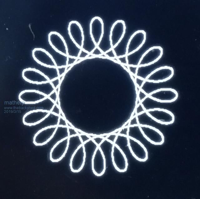

200,105,90

Your diagram reminds me of plotting the locus of a point with interlocking circles when I was at college. It was 'orrible as I remember, no PC's back then, but we were using the generic circle equations I think, not trig functions.

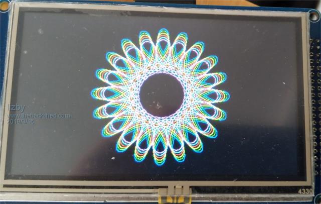

  paceman said  ... I played colours with your first code
Nice on a 4.3" SSD1963 on an H7 backpack-144:
But I got this:
save "spirograph2.bas"
> run
parameter inc = 4
[22] Pixel x,y,culla(z)
Error: Index out of bounds
Don't know what more should have appeared.

Nothing more Lance, that was it. I was lazy finishing it off. I'm using a 4.3" SSD1963 too - did using inc=2 make your eyes go a bit weird too?

  lizby said   But I got this:
> run
parameter inc = 4
z should maybe wrap around instead of going on incrementing, or the program should stop when it reaches the size of culla()

OK, a quick wrap-around. Add the line below as the second last line, i.e before the 'GOTO change'.
If z=6 then z=0
Stop it with a ctrlZ when you think it's pretty enough.
