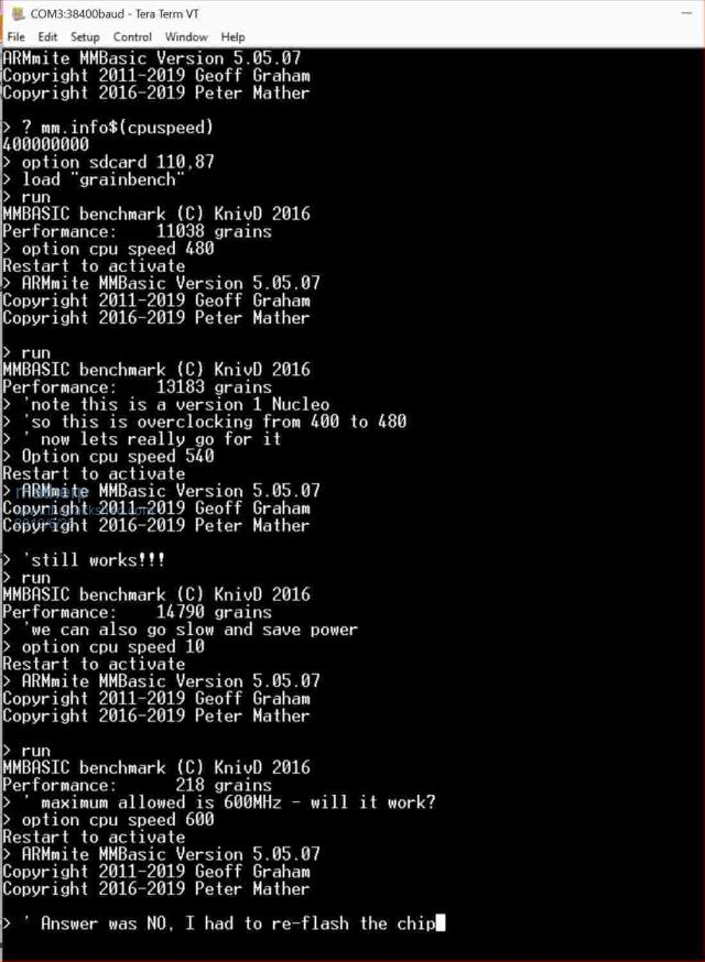

Note: If you overclock and the processor doesn't run you will need to re-flash. Other ways of resetting can't work in this case. The test above was run on a V1 Nucleo so only specced for 400MHz but ran fine at 540MHz!!!

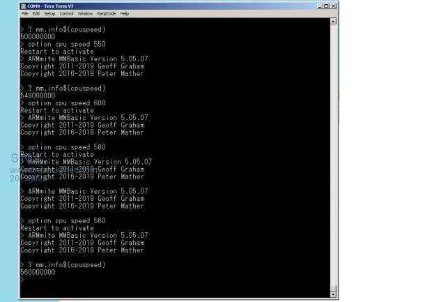

Peter, thanks for the updated firmware with ability to change CPU clock rate on the ARMmiteH7.
I can push the clock rate on my NUCLEO-H743ZI2 to 560MHz. However it is does not boot at 580MHz or 600MHz.
-- Gurbir
