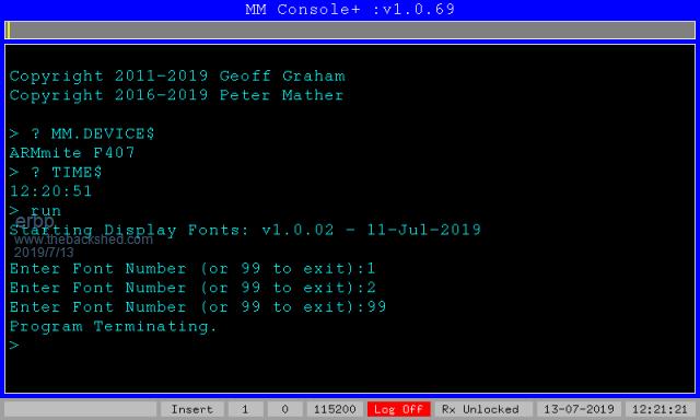

The following are details of the project I have just completed, which may be of interest to some.
It is using one Micromite as the Console for any other Micromite that it is connected to. This project came about as I didn't have a PC located in my workshop, so I found I was spending more time moving MM's, modules, test equipment, power supplies, etc., from the workshop to where the computer is located (and back again) than I was in productive development and testing. I thought - "why not use a Micromite to act as the Console, why do I need a computer, after all it just needs a serial comms link?" So after a small proof of concept project was successful and I got quite excited about the idea of not needing a PC to do many of the tasks related to "doing MM stuff", the MMConsole Plus (MMConsole+) project was born. Although I now have a computer in the workshop, I find I only use it for loading firmware to Mites, major development coding, reading TBS and the occasional Googling to get the answer (or not) to a vexing question. I much prefer to use MMConsole+ to work with other Mites.
Below is a screen shot of one of the main screens of MMConsole+ acting as the console for a connected ARMmite F4 and running a few commands, including initiating a program that I had just uploaded to the F4 via MMConsole+.
Below is a slightly reformatted extract (in blue) from the first couple of sections of the MM Console+ User Guide document included in the attached release package. This gives more high level detail on functionality and hardware requirements. If you feel this might be something that you would be interested in, the User Guide provides a lot more details including over 20 screen shots.
