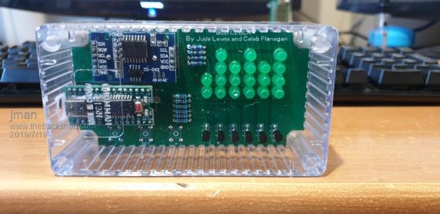

I thought I would share this little project.
Some kids from the local school wanted a tech project for school and a Binary clock seemed a goods fit. This was a great introduction to MMBasic as they have been learning PicAxe Basic at school the transition was not hard.
The kids built their own clocks (Soldering etc..) so the finished item is one that they made themselves .
Thanks to Grogster for the PCB design and to Westie42 for the PCB manufacturing.
The attached file has the necessary files and a link to the clear case from Element14
Needless to say we have some pretty proud school kids :) and hopefully some more MMBasic users.

Great school project, just one thing, in the code
Sub DisplayTime
'Hours
Port(2, 4) = Hour(1) 'Set the Column on
Pin(21)=1 'Turn on Hours Tens
Delay
Pin(21)=0 'Turn off Hours Tens
what does the line 'DELAY'do I can't find it in the manual ?
Does the user insert a pause.Edited by palcal 2019-07-20

hi jman
  jman said   Hi
good idea for kids, and good job
just a note for a variant of your program, it's the idea of using a table for the time datas which would allow to use a loop for the display
'Dim Hour(2), Minute(2), Second(2)
'replace by
dim vtime(6) as integer
Sub DisplayTime
local i%,j%
j%=21
for i%=1 to 6
Port(2, 4) = vtime(i%) 'Set the Column on
Pin(j%)=1 'Turn on Hours UnitsDelay
delay
Pin(j%)=0 'Turn off Hours Units
j%=j%+1
next i%
end sub
a small problem: in your main loop, when time change from 23:59:59 to 00:00:00, it call "gettime". why not, but if real time is 23:59:5x, it call "gettime" twice
it is not importante, because in second call it will be correct!. And if rtc is out, you can read "00:00:00" at each call gettime, and in this case, you loop. it is juste to show one of timer's prog problem (there is many others )
