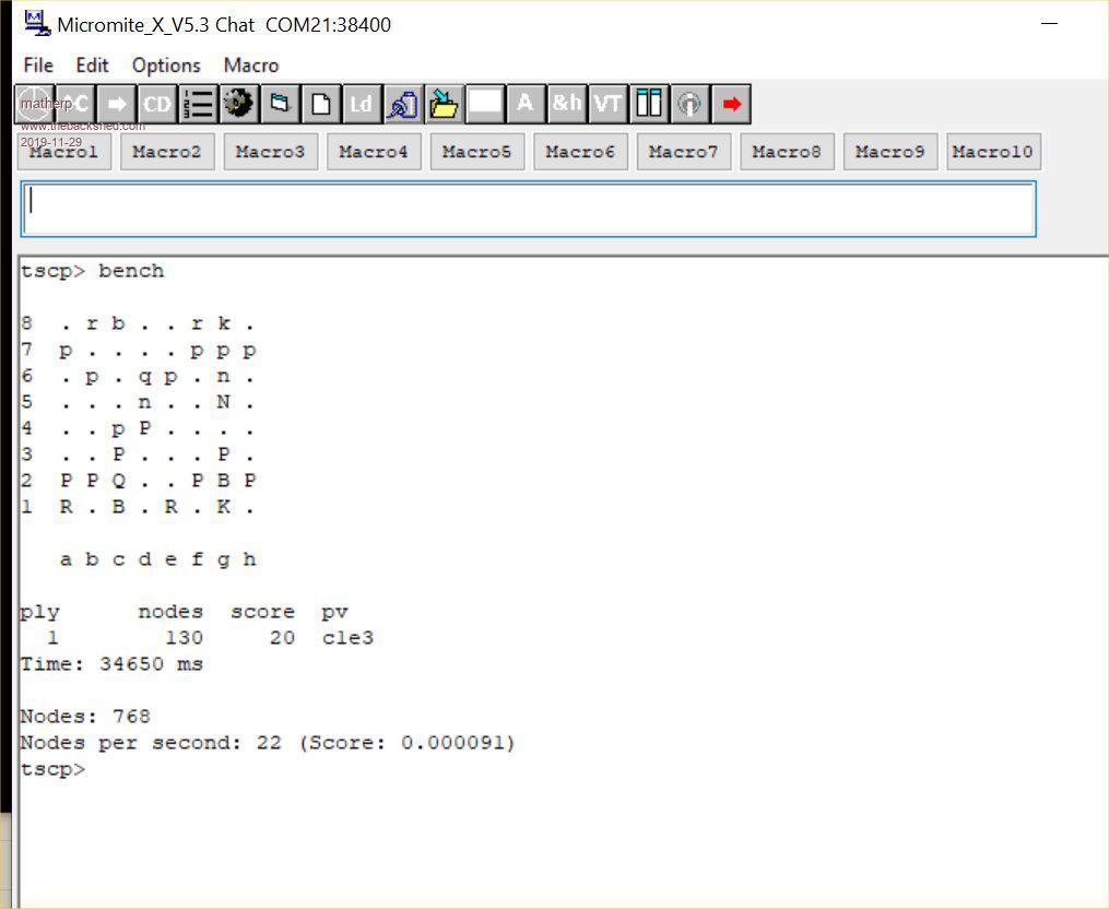

Is this a full test on ArmmiteH7?
Note: I had to change variable LINE$ to something else as LINE is a reserved word
Edited 2019-11-29 18:47 by matherp

Thanks.  The bench score is relative to an Athlon XP 2000+ processor running the compiled C version which is supposed to score 1.0.  I compiled and ran the C version on a Pi Zero and it scored 0.436
If the benchmark test is working correctly, the Armmite is about ten thousand times slower than the Athlon running the compiled C version.
But 22 Nodes per second is pretty good for MMBasic.  The DOS version of MMBasic on my i7 2GHz laptop only does about five times better: 118 nodes/sec
