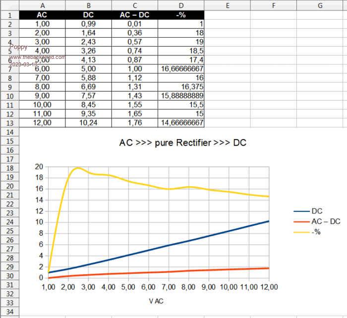

Hi guys,
has anyone done that yet and how?
Is there any special way to measure True RMS somehow or is it actually not so important?
Could it be as simple as measuring DC behind a rectifier and calibrating it down to the original AC value?
For example:
If I take 12V AC and after the rectifier and capacitor I get let´s say 16V DC, then the MM just calculates
DC-(DC-AC)?!?
And of course it needs a voltage divider, not to fry it!

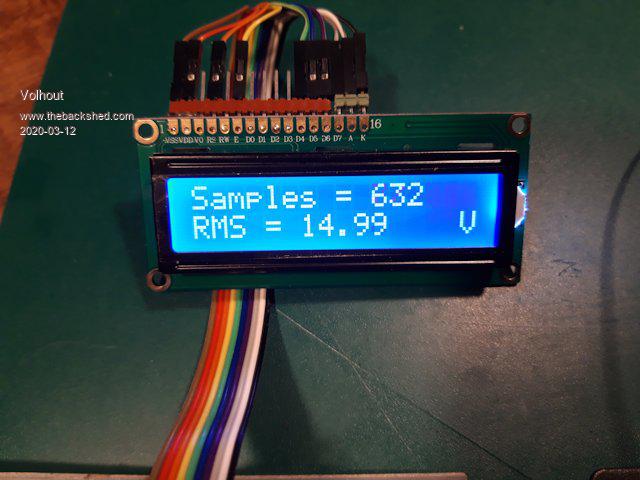

Hi Poppy,

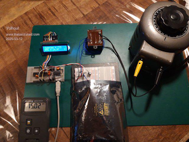

I was a bit optimistic on the sample rate achievable, but I have an example for you anyway. I hope this is of any use.
The circuit and algorithm are for measuring AC voltages. In my test I have used a variable transformer driving an small 230V->18V transformer (for isolation, don't want to electrocute myself).
The RMS (abbreviation for R(oot), M(ean), S(quare)) is calculated from an array of 800 samples, between 2 zero crossings. The measurement values are accurate (checked against a Fluke multimeter) within 1 percent between 0V and 20V.
In this example I display the RMS value at a 16x2 LCD.
It also shows how many samples are used to calculate the RMS value.
The circuit diagram (measurement input)
Note that the input is not isolated, if you want to measure mains voltage, you have to insert a transformer for isolation.
The test setup
The LCD displaying samples and RMS value

'|                     RMS convertor for MX170                  |
' The RMS value of a signal is the R(oot)M(ean)S(quare) value.
' It is calculated by adding up the squares of the input signal
' The mean of these squares is rooted. This process is explained
' in the steps below.
' This example uses the ADC in the PIC32MX170 to measure the
' AC input signal. Output is displayed at a 16x2 LCD.
'----------------------  Defines -------------------------------
ADCpin = 23         ' ADC input pin
Total = 800         ' array size for measuring 220mSec @ 48MHz
Offset = 1.650      ' numeric offset at 3.300V
CalValue = 24.85    ' gain factor attenuator and AC coupling @ 50Hz
Option explicit
'------------------------- Dim Variables --------------------
Dim Sample!(Total)
Dim SumSQ!, Value!
Dim i%,j%,a%
'---------------------- Initialize hardware -------------------
SetPin ADCpin, AIN  ' initialize ADC
CPU 48              ' maximum speed for the MX170
'LCD
LCD init 4,5,6,7,2,26
LCD 1,1,"Samples =       "
LCD 2,1,"RMS =          V"
'--------------------------- Measuring ----------------------
   'sample input signal
   For i%=1 To Total
     Sample(i%)=Pin(ADCpin)-Offset
   Next i%
   'find zero crossings
   i%=0:j%=Total-1
   'first zero crossing in array
     i%=i%+1
   Loop Until(Sample(i%)>0 And Sample(i%+1)<0)
   'last zero crossing in array
     j%=j%-1
   Loop Until (Sample(j%)>0 And Sample(j%+1)<0)
   'calculate SQUARES
   SumSQ!=0
   For a%=i% To j%
     SumSQ! = SumSQ! + (Sample!(a%)*Sample!(a%))
   Next a%
   'calculate MEAN
   SumSQ! = SumSQ!/(j%-i%)
   'calculate ROOT
   Value! = Sqr(SumSQ!)
   'display values on 16x2 LCD
   LCD 1,11,Str$(j%-i%)
   LCD 2,7,Left$(Str$(Value!*CalValue!),5)
I hope this can help you on your way...
P.S. the "CalValue" can be calculated from accurately measured 3.3V, resistor and capacitor values. But for the demo, the value is just "tuned" to get full range identical values to the Fluke multimeter, and values between 1V and 20V are checked for accuracy (linearity).
P.P.S. the accuracy increases with the number of samples. With 2000 samples it is better than 0.5%, but measurements take 1 second.
Edited 2020-03-12 07:19 by Volhout

Some notes on the circuit:
R5 and R6 (10k 1%) are used to centre the signal around the middle of the ADC. These resitors need to accurate to get exactly at the middle of the range, else they create an offset (and a measuring error).
To minimize the offset you can either
- adjust resistor values to get exactly middle of your 3.3V
- change the "Offset" value in the program to display exactly 0.00V RMS when there is no input voltage (short input pin to gnd).
The ADC has 3.3V range, the centre is 1.65 V. Therefore the input signal can be +/- 1.65V max at the ADC.
The current component values (R4=120k, R5/R6=10k) attenuate the input signal (120+5)/5 = 25 times. So the maximum measurement range is +/- 25x1.65 = +/- 41V. If a sine wave is applied that is maximum 41/1.4 = 30Vac
If you need more range, you will have to increase resistor R4.
Capacitor C1 can be a low voltage part. Typically it has only 1.65V across it.
Protection diodes are not in this circuit since the R4(120k) limits the current sufficiently to rely on the internal protection diodes inside the MX170. If you are in a very dirty electrical environment (welding equipment, large pumps, Tesla coils...) you may want to add them though.
The duinomite is an MX470 (same as maximite), so it should run faster than the MX170. Remove the CPU 48 command from the program, it will throw you an error.
Edited 2020-03-12 21:07 by Volhout
