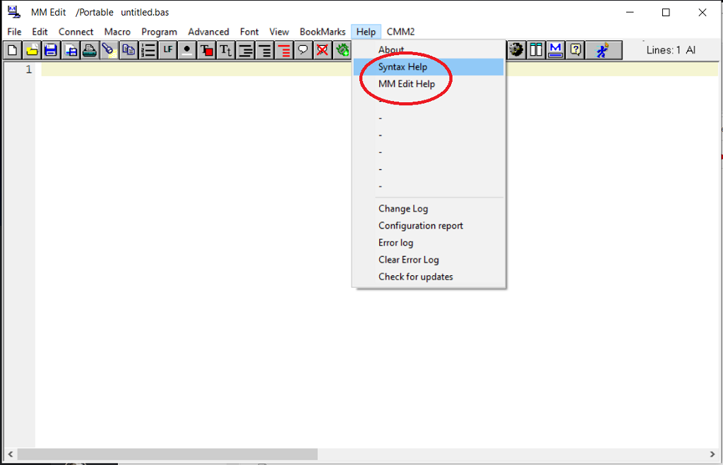

I gave the portable version of MMEdit a try yesterday.  Running under Windows 10 x64.
When I tried to print out a piece of sourcecode
so that I could anotate it and make a few pencil notes
I came acros a problem on my system.
The printout came out completely "redacted".  No text, just black boxes where lines of text should be.
I appreciate this is almost certainly a Windows Printer Driver issue.
I am using an Epson AC1100N with the generic windows driver connected to the machine via ethernet.
Have other people successfully printed out from this version of MMEdit ?
If so were you using an earlier version of Windows ?
or is this to do with running it in portable mode ?
I then went to have a look in the MMEdit help system ... see below
MMEdit Help  ... worked fine, opened in Windows Help
Syntax Help ... Nope, nothing happened
I assume this is because a .CHM file has not been written for the Syntax Help
Comments anyone.  Am I being dim (again) ?
Posts: 6626
Posted: 12:09pm 26 Jul 2020
Syntax help will only appear if you have a keyword selected. Then it will show the help for that KW (if available)
There isn't much help for the new keywords yet.
Print should work, not that I use it much, but I just tested it.
You can try 'save as rtf' and then open it in your preferred word processor and print in colour from there.
