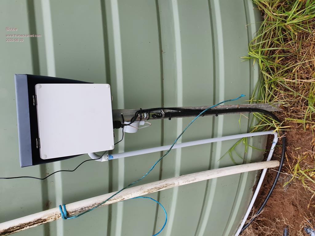

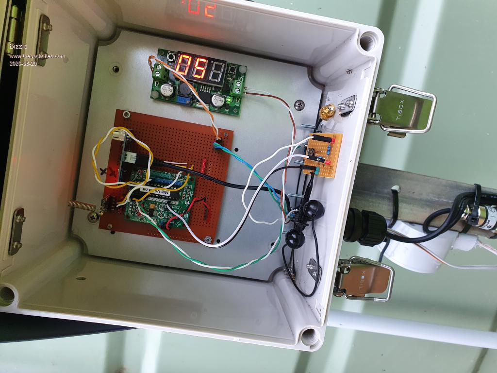

Yes the early short on/off periods are correct the cattle had a big drink before the bad weather of yesterday set in!
Here are two images (not sure how they got on their sides!) an overall shot and inside the box. The 20mm conduit supplies 12V dc while the large pipe is the tank filler.
Inside needs some tiding up work but contains a MM170 on one of Big Mick's boards, the depth sensor board sits vertically (ringed by the yellow and white twisted pair wires), The signal conditioning board lies on the bottom of the case at this time while you can see the HC-12 top left.
At the PC end there is another HC-12 and USB-Serial converter. Software wise I am running a VB.NET console app to communicate with logger, record the data and send the emails.
Thanks again all for your help.
Rob White

Posted: 07:38am 20 Aug 2020
@Bizzie
Nice work! I love real-world uses like this. I still get a buzz from really useful stuff like this.
Consider putting a silica gel pack in the enclosure.

@CaptainBoing
Thank you. This project has a little more to it that what you see on the surface and your to thank for that! While not using your networking software from Fruits of the shed directly. I am developing a system where the loggers (of any data types - Pump pressure, Tank levels, Rain gauges etc) chache their data and then when polled send the data out a serial connection. There may be a HC-12 link in that line.
A big thank you to all on TBS who have helped me over the years.
Rob White
